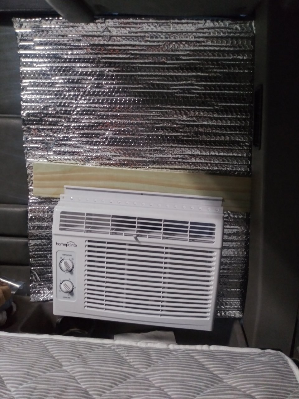

  10. HillbillyDeluxeTruck
    5,934
    30,338
    Mar 3, 2013
    San Antone
    So my roughed in, temporary ac mount has pretty much stayed the same since last year, lol.
    In S Tx heat my 2k watt Predator generator runs for 10-12hrs with the ac unit keeping it as cool as I want in the sleeper. Ive checked and right where the air blows over me, it'll be 68 deg. I usually turn it up and let it cycle most of the night at around 75 deg.
