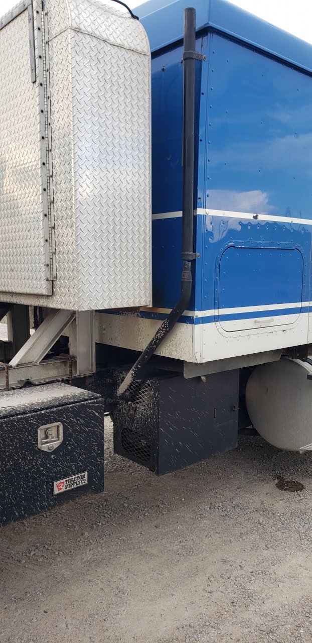

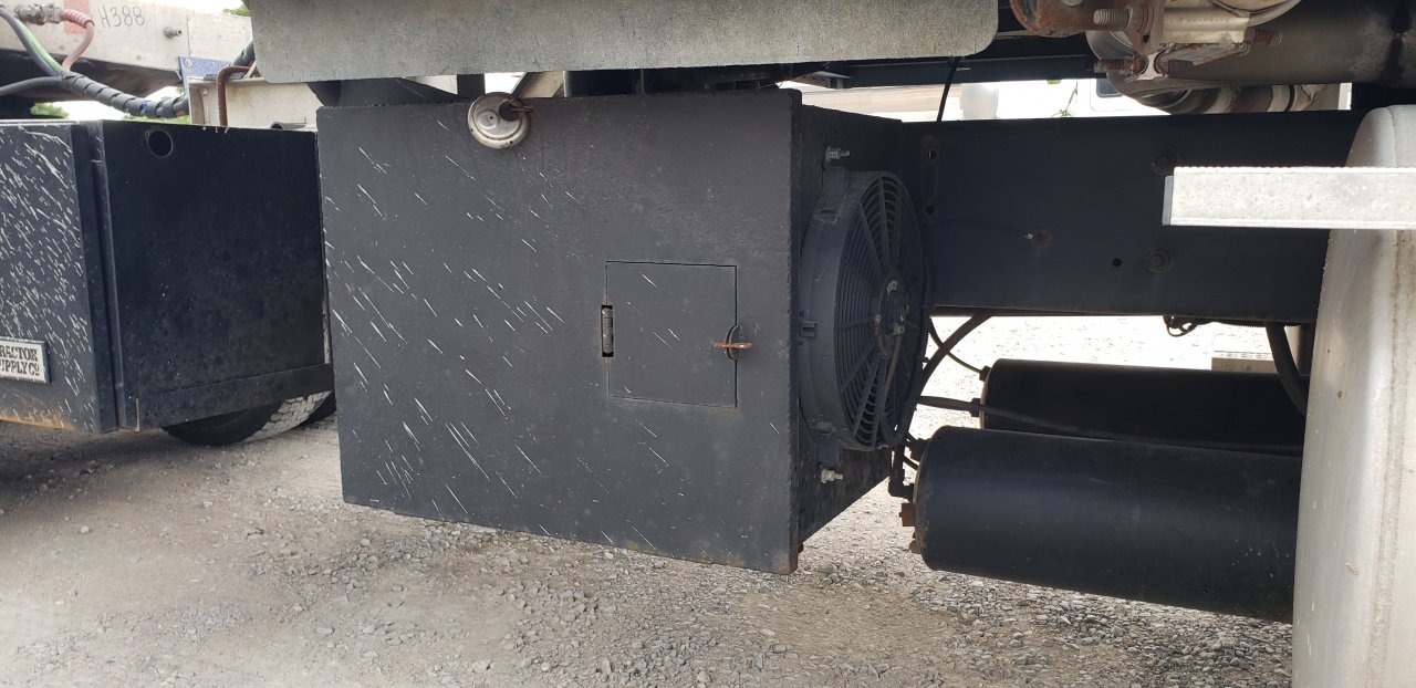

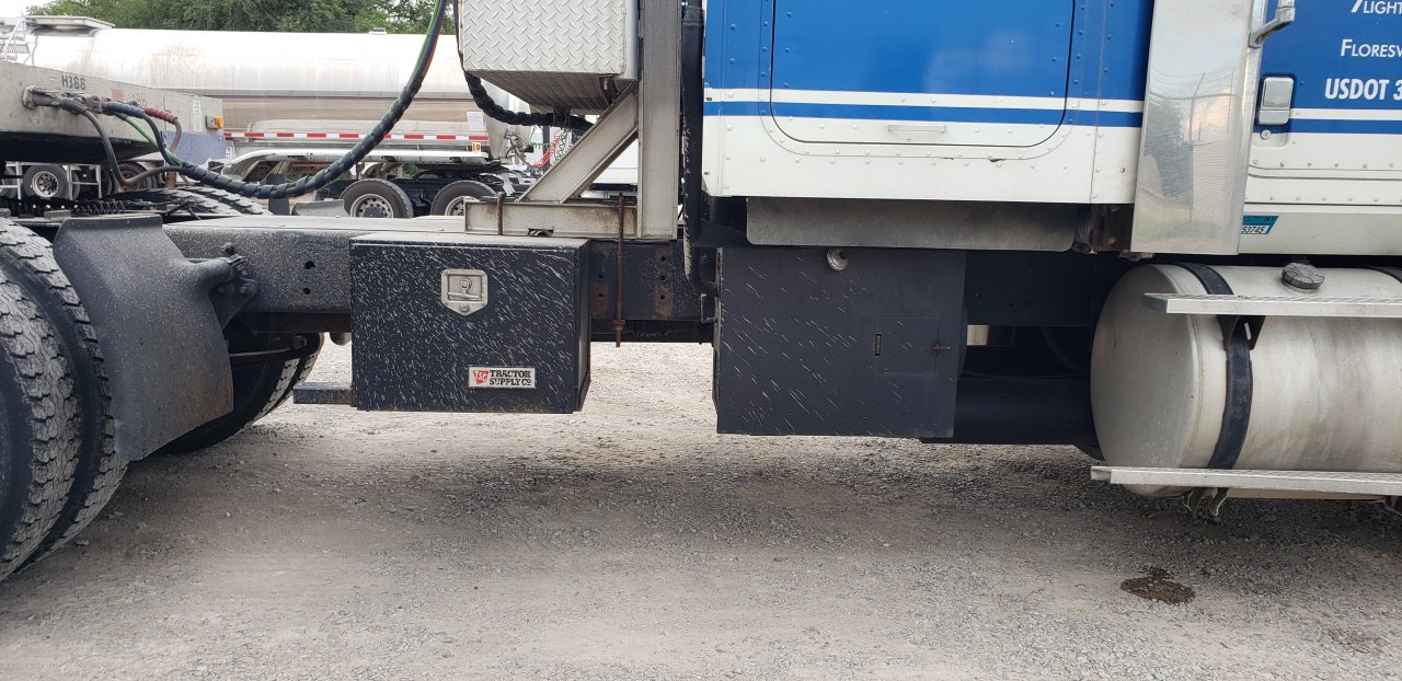

  9. God prefers Diesels
    4,198
    22,261
    Jun 26, 2020
    South Texas
    Do you have room on your frame rail?
