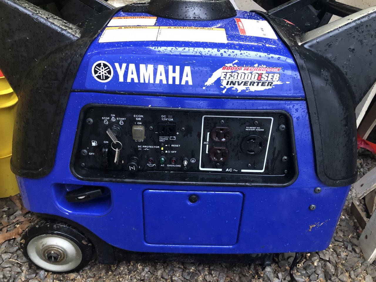

    I paid $1200 for this one. Barely used. There were none available from the factory when I bought it a few months ago. I will install after I get a toolbox and modify to my liking. Getting a new engine in a few weeks and I want this installed the same week. It will be nice to keep idle hours down from the get go. B94C6008-9007-4693-9EB1-192DA8AAB5E9.jpeg

    I was going to install an Espar as well so I didn’t have to run the generator at all, but I’ll be using it for the block heater so may as well just use the $30 space heater. Cold starts are cool on YouTube but I hate them on my truck LOL.
