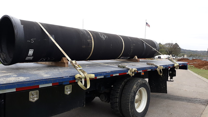

    Pics of a couple loads I hauled today.
    That big pipe is 30" ductile. Weighed 3108 lbs. Had a 30" 90 degree fitting on as well... bunch other stuff too.

    I like what you are doing but have a couple suggestions
    1-pull a couple of those straps the other way on the plastic pipe
    2-on the ductile pipe try to put your dunnage blocks right under your end straps
    3- running your wrap straps over then under and over again puts more downward pressure on the load.
  11. starmac
    starmac Road Train Member
    6,639
    12,528
    Apr 11, 2019
    Fairbanks Ak
    On my gut wrap straps, I just threw them across before loading the pipe, then over the top, so you are pulling down on the pipe. I have watched guys do it by throwing it over the top and fishing it under, but all that is doing is holding it towards the center, not down.
