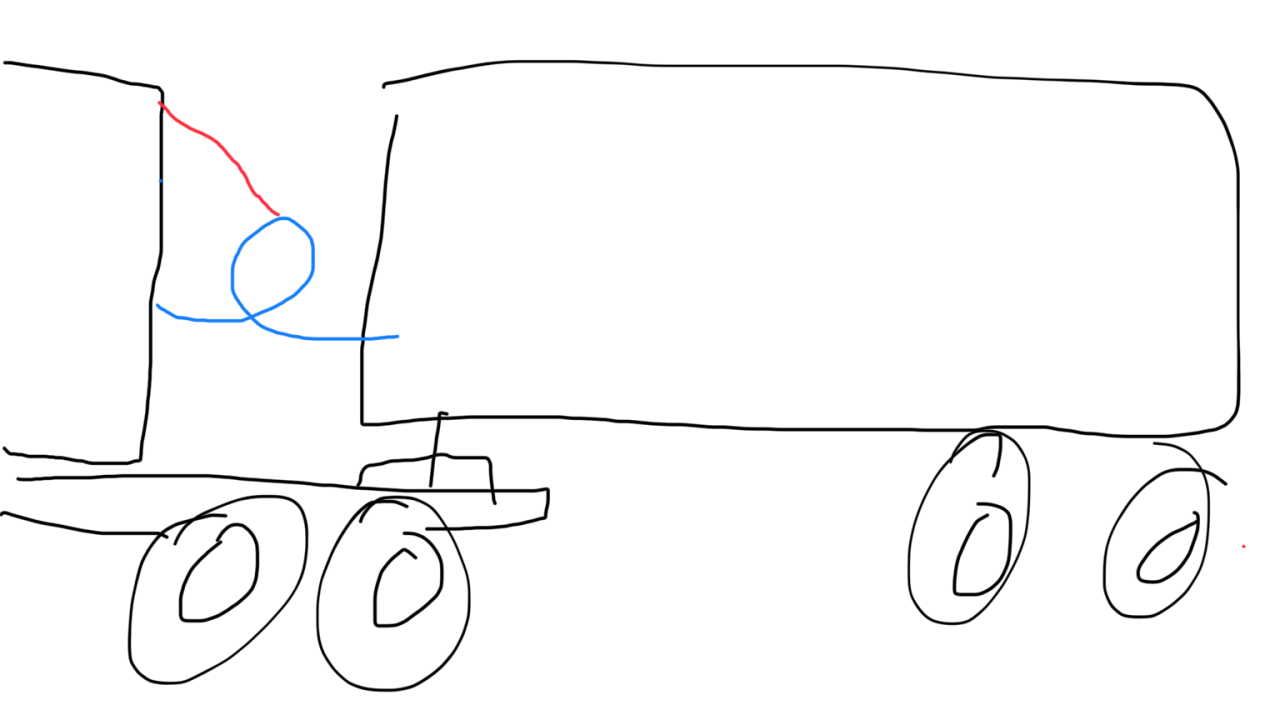

    Make a loop in the lines, then attach one end of spring to your tracker bar and other end to the top of that loop. I’m not near my truck right now so can’t take a pic.

  10. Kyle G.
    Kyle G. Road Train Member
    3,914
    20,654
    Jan 23, 2016
    Eastern Iowa
    Forgive the crudeness of my drawing.
    By the way, i sell copies of my artwork for $500,000
  11. '88K100
    '88K100 Road Train Member
    1,519
    3,771
    Aug 23, 2020
    That’s how mine are set up,,,keeps em off the deck.
