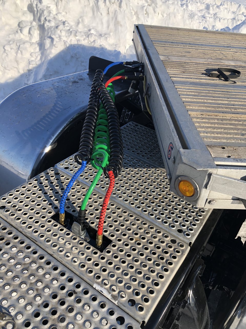

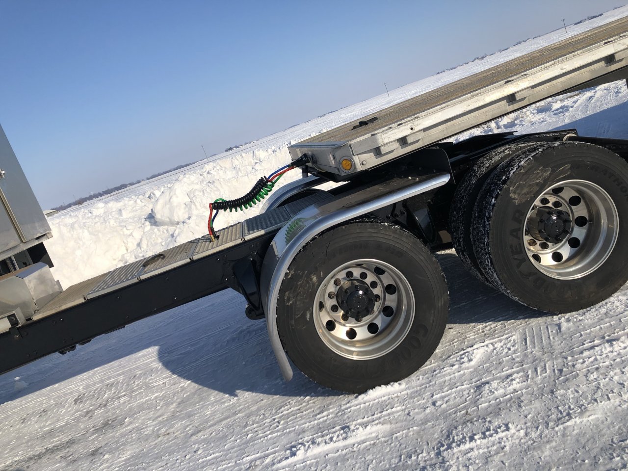

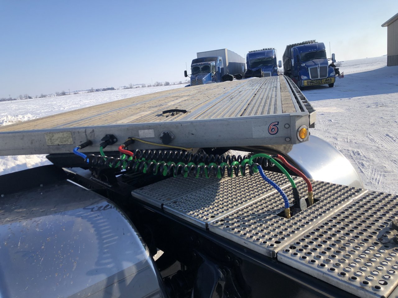

  1. Kyle G.
    Kyle G. Road Train Member
    3,901
    20,571
    Jan 23, 2016
    Eastern Iowa
    LOL, see post 22

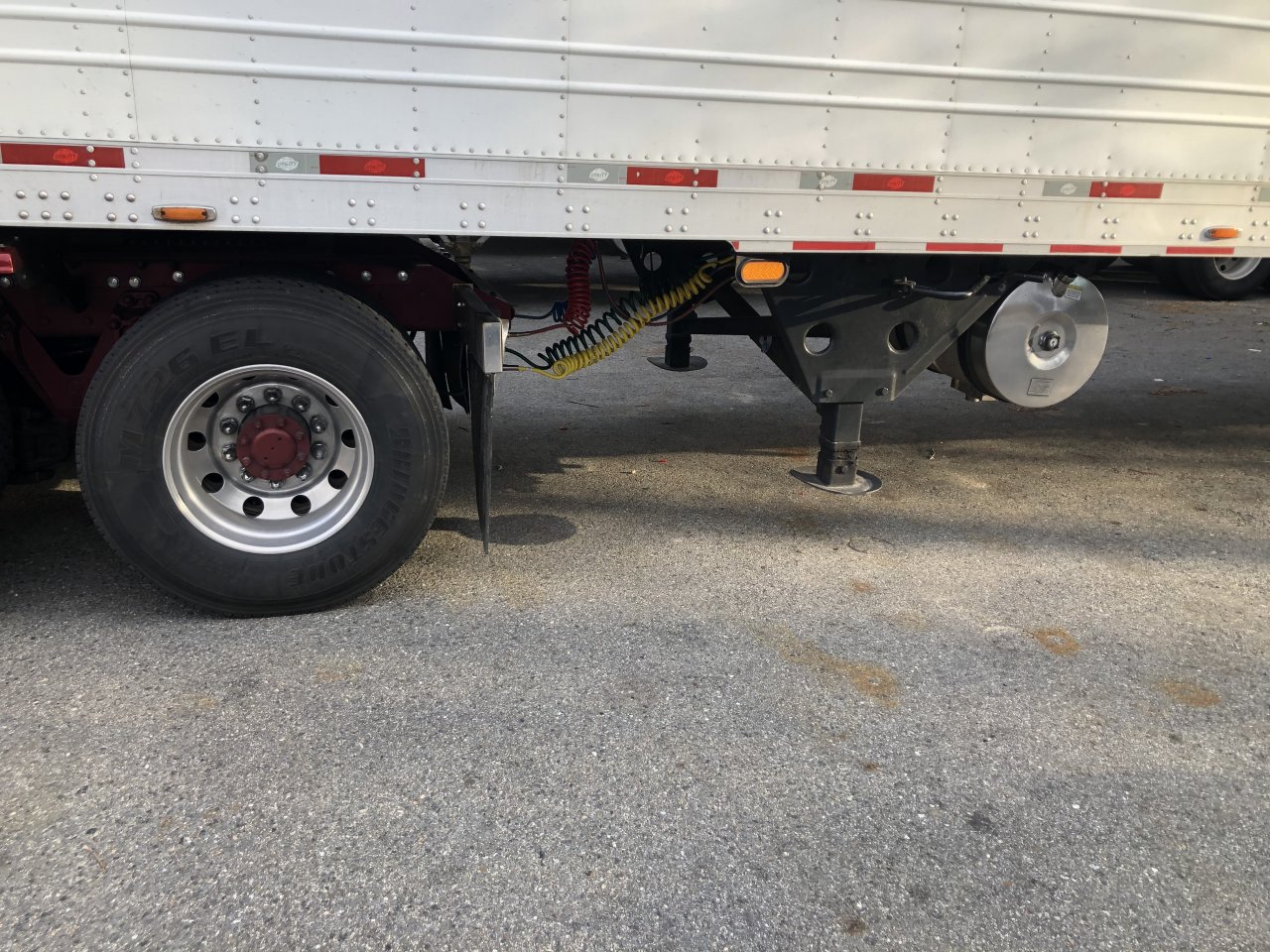

    Is it your trailer?
    cali connects

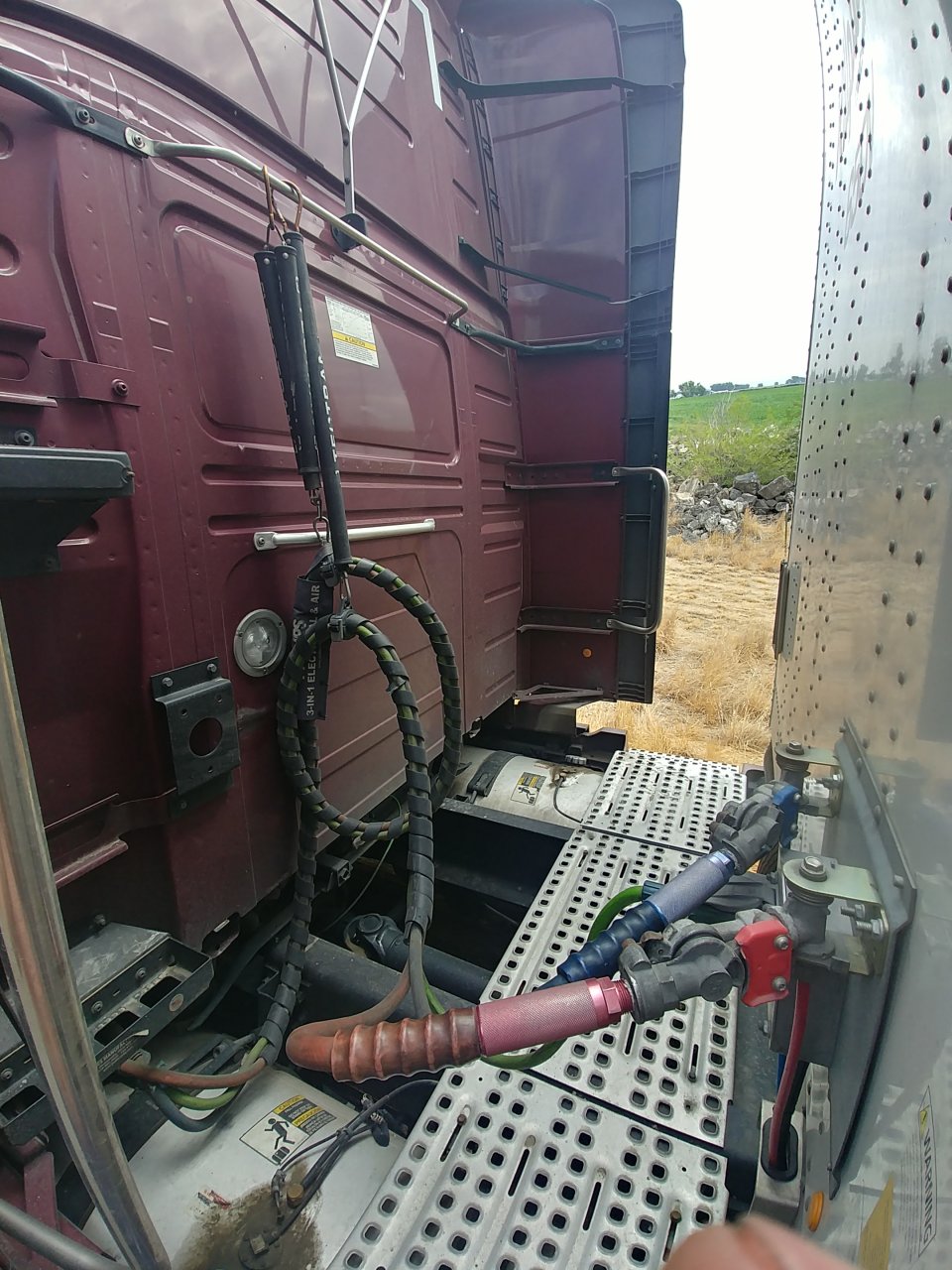

    Much better now...
