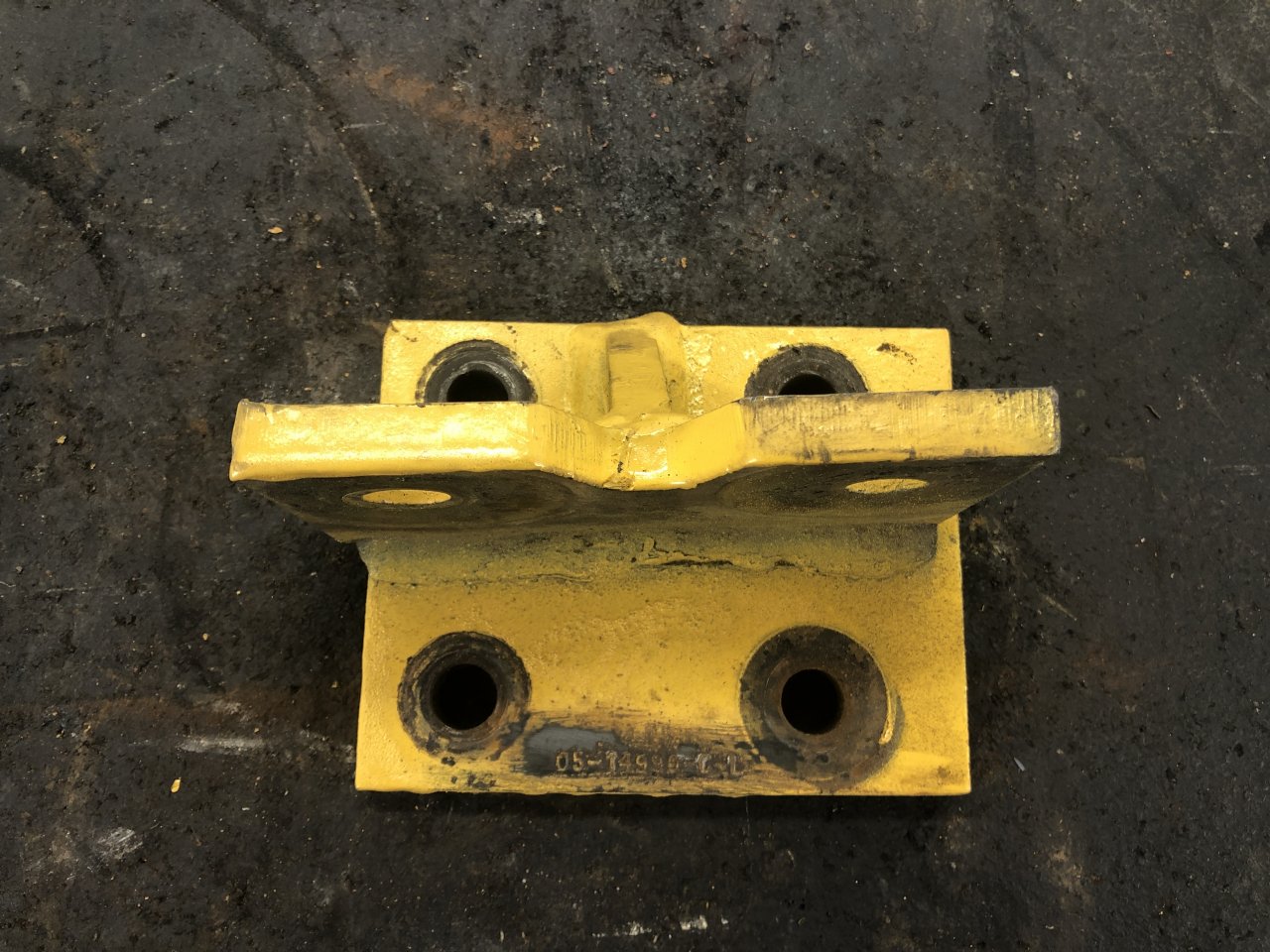

    That mount looks angled. Not sure if that's what you want
    05-15272L and 05-15272R are the part numbers off my build sheet. Google doesn't come back with anything for many of those old parts numbers but you can call Vanderhaags or LKQ and they might look for them. Not sure if the mounts were different between Pete and KW

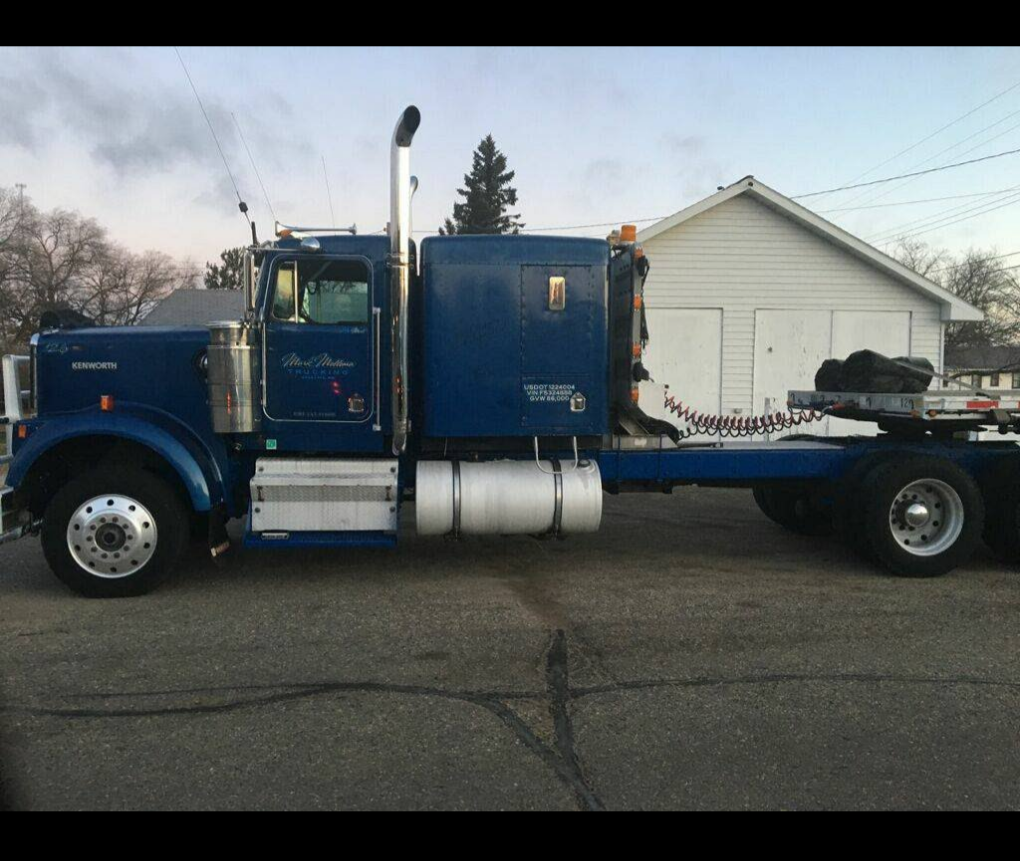

    YES, well I'm not known for my skills in explaining anything so yes. The cabover ls a 1980 Kenworth k100c with a 1986 big cam 3 400. I am wanting to try to use the engine mounts on that to a 1985 Kenworth w900b. I am assuming from looking at other pictures of w900b with the big cam engines stock it looks to be in same spot for engine mounts (picture of engine isn't mine)
