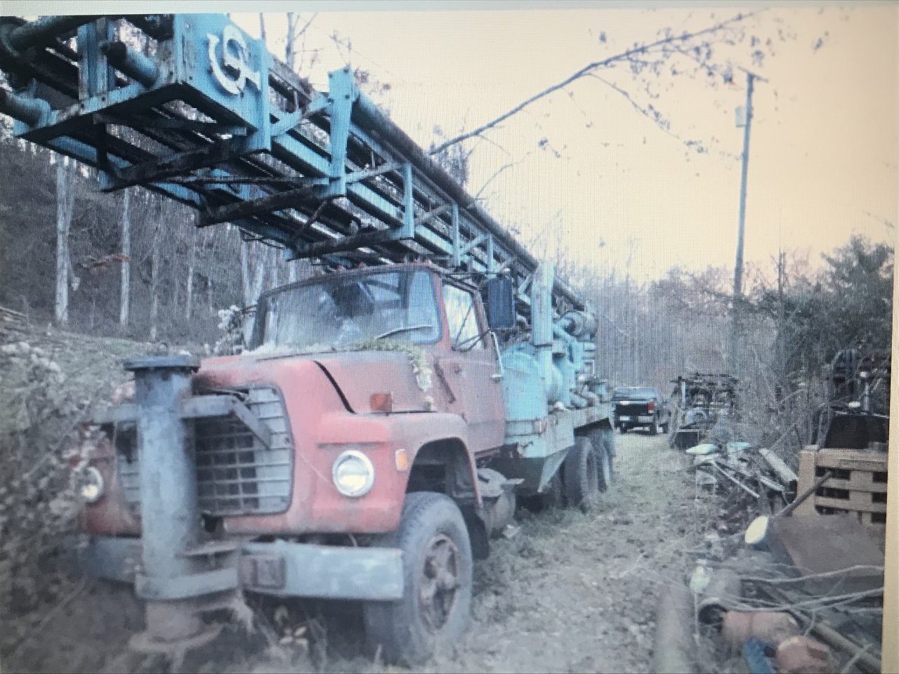

    The drill rig is a 1978 Chicago Pneumatic RT1800.
    650cat425 and OLDSKOOLERnWV Thank this.
