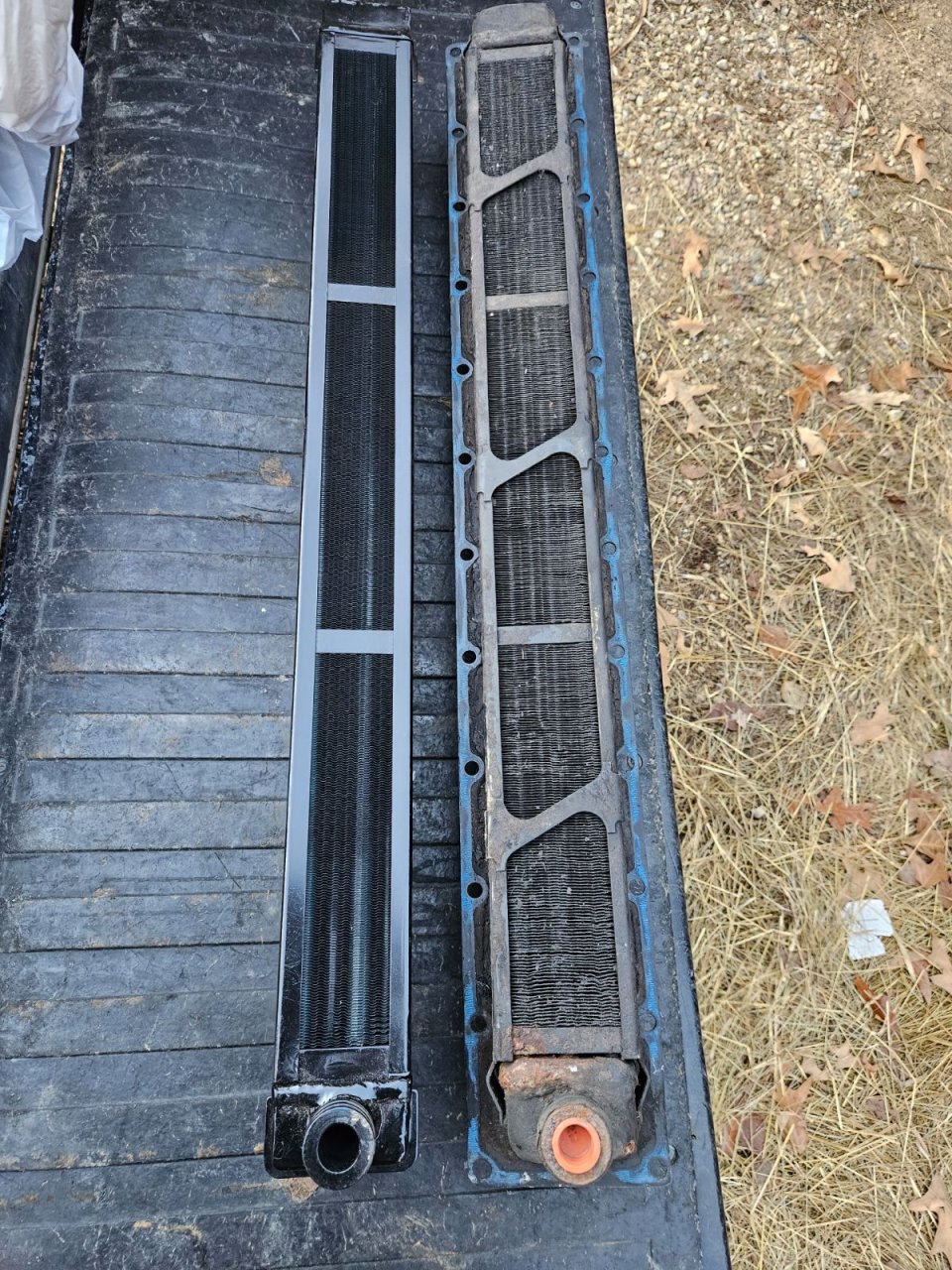

    image000000.jpeg The older cooler housings that had both top and bottom, aluminum castings, use an exchanger with no flange around it. The housing with the aluminum lower casting and stamped upper housing, uses an exchanger with a flange.

    Not sure but the one on the left, May be for a series 4.

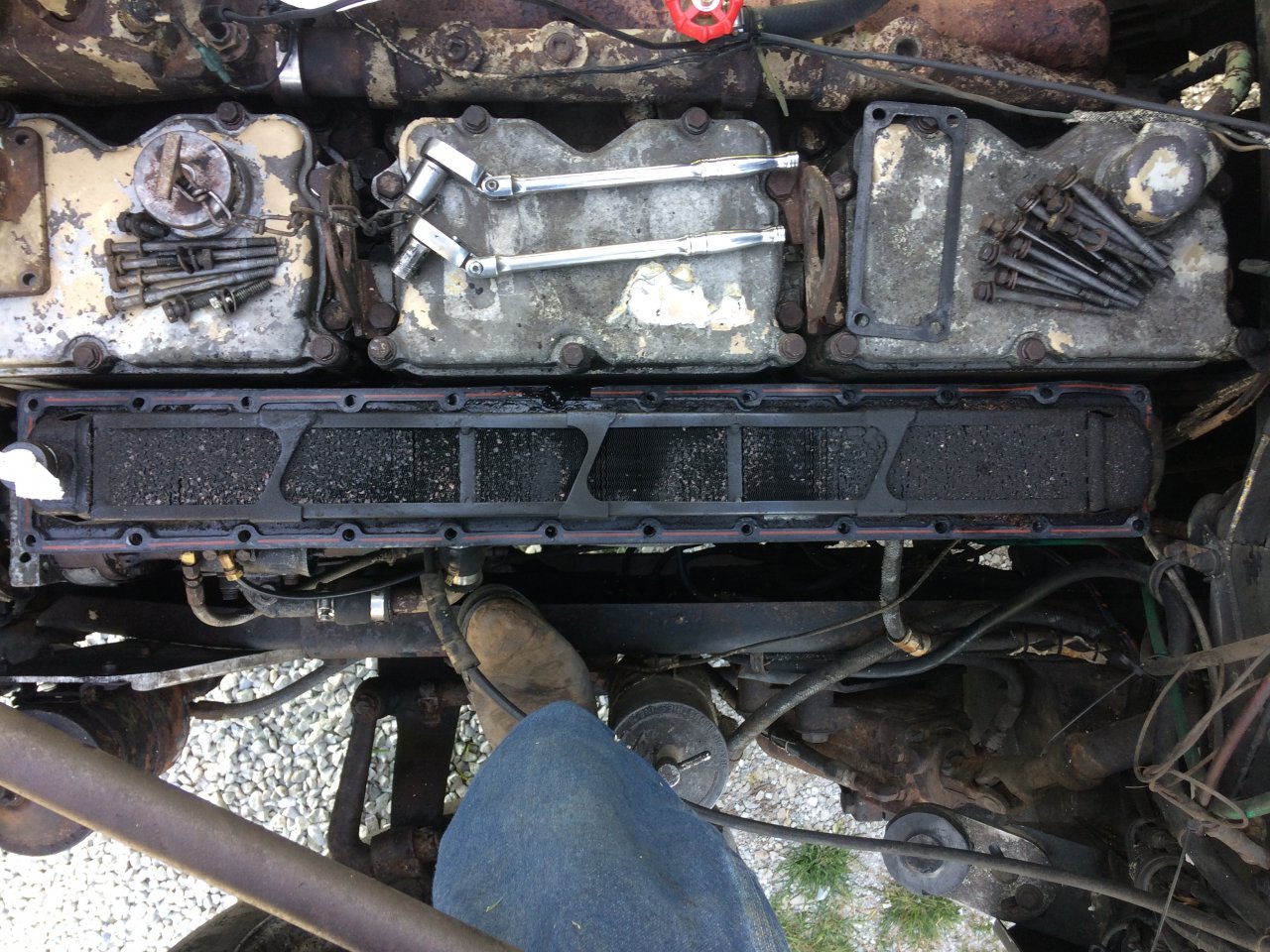

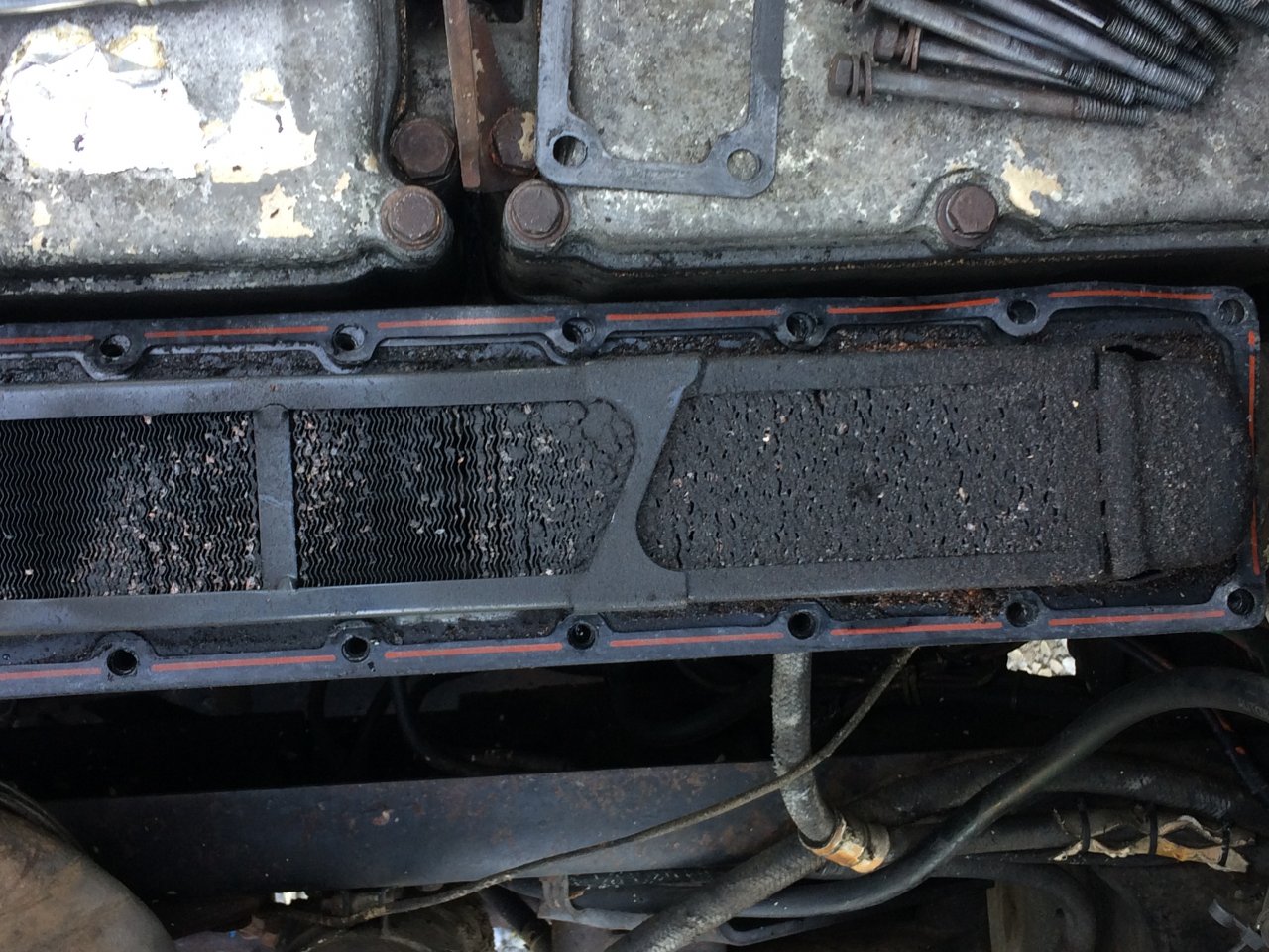

    The one for the big cam 4 looks 100 percent different from those. It looks kinda like the flat oil cooler in the 8.3 Cummins. I thought I had one on the shelf to get a pn but apparently not…
    I am not certain on the flange no flange deal but I sure think I’ve seen the flange one in aluminum top coolers. I am pretty certain this one has a flange and it’s on a small cam with an aluminum top. IMG_2471.jpeg IMG_2473.jpeg IMG_2471.jpeg

    What the heck got into that one?

    Oil from the turbo leaking until it sucked a hole in the air filter and then a whole bunch of red dogs from corn. It was an auction buy…it didn’t run right but that was also because of the broken injector rocker.
