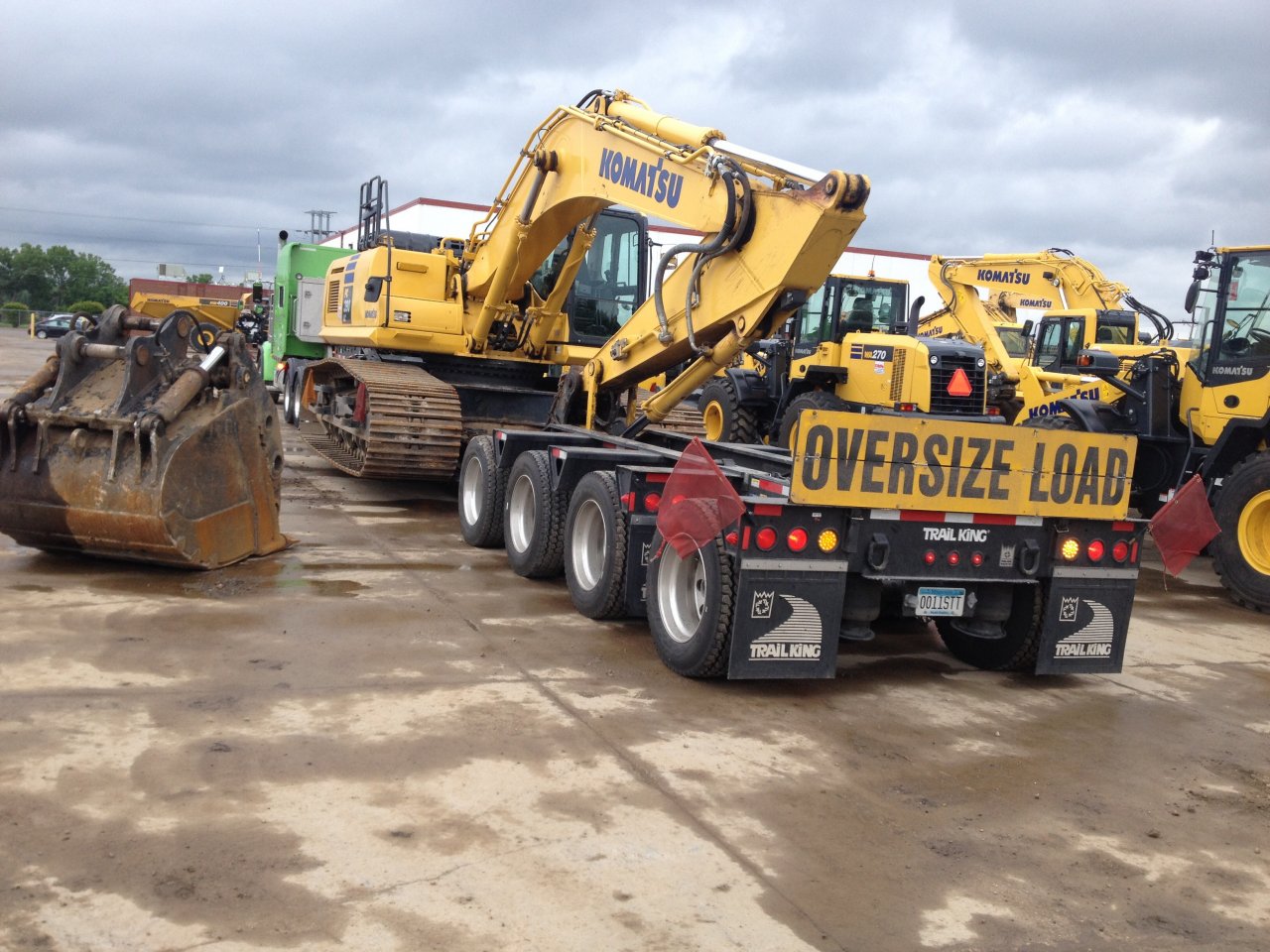

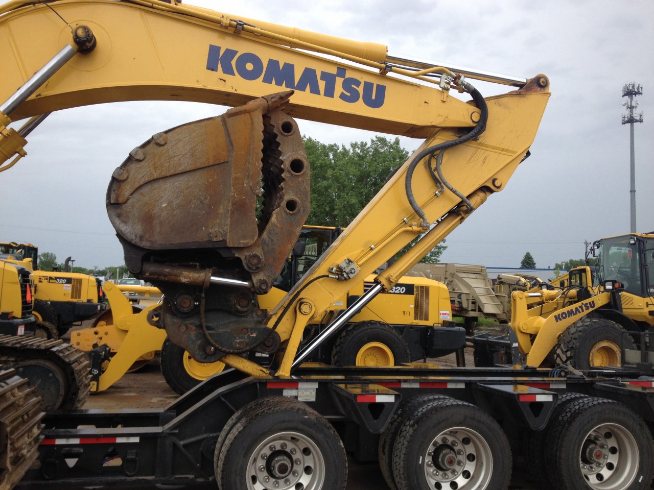

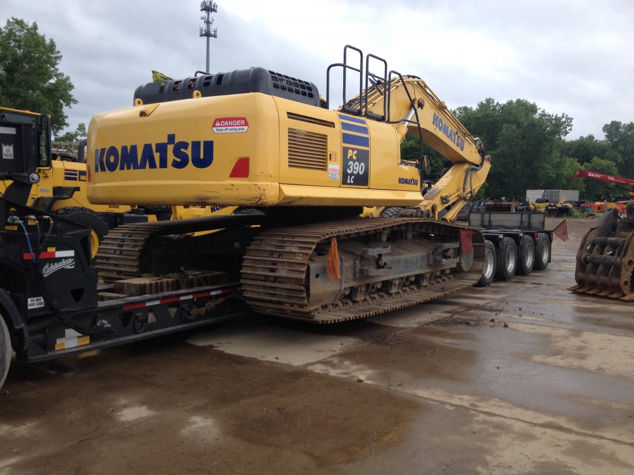

    Loaded this up this morning, had to leave bucket behind. Wasn't able to curl it enough to get down inside the boom trough, was 15'4" before dropped bucket. Was going to move machine back a bit and put bucket down in the well but for how far I would of needed to move it I would of been way over on truck. Ended up 17,700 steers 59,160 pusher/drives and 64,720 trailer quad. Had to slide 5th wheel all the way forward image.jpg image.jpg

  8. passingthru69
    Skooter here's a trick for thought
    Next time put more blocking under the front of your machine. Changes the pitch of your boom and stick. Thus allowing the boom to be lower

  9. johndeere4020
    8,522
    119,293
    Jan 1, 2010
    Where you not able to curl the coupler more?
  10. skootertrashr6
    skootertrashr6 Medium Load Member
    639
    6,942
    Jan 4, 2012
    Pueblo, Co
  11. skootertrashr6
    639
    6,942
    Jan 4, 2012
    Pueblo, Co
    Thanks for the tip, I'll have to try that for sure next time!
