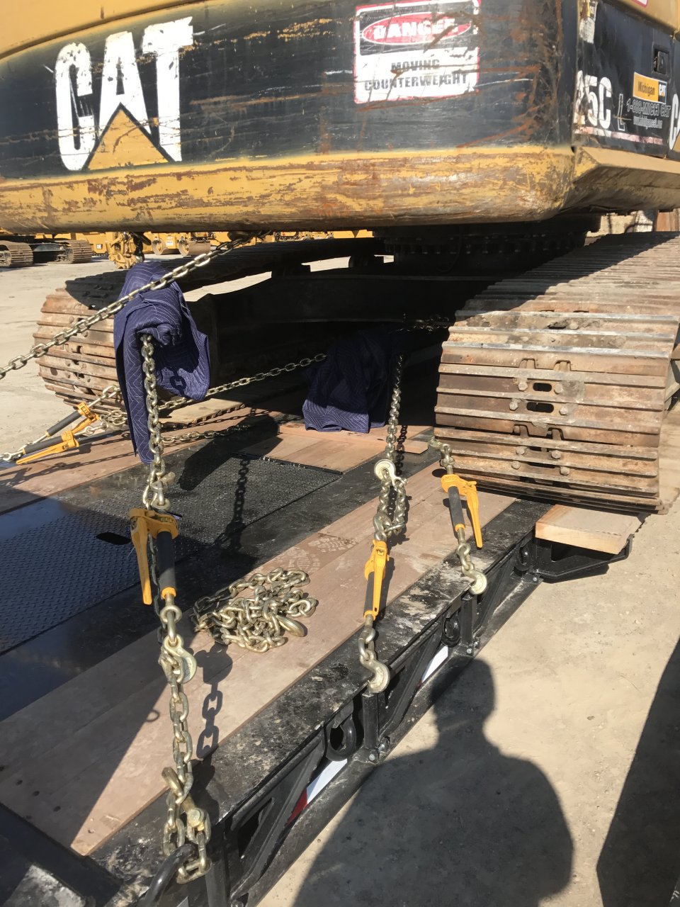

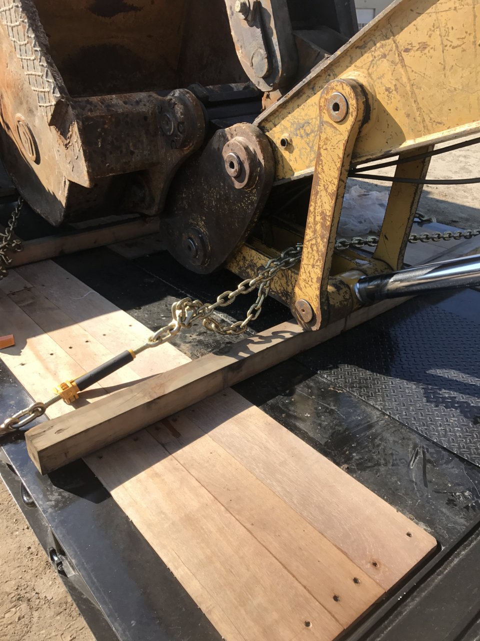

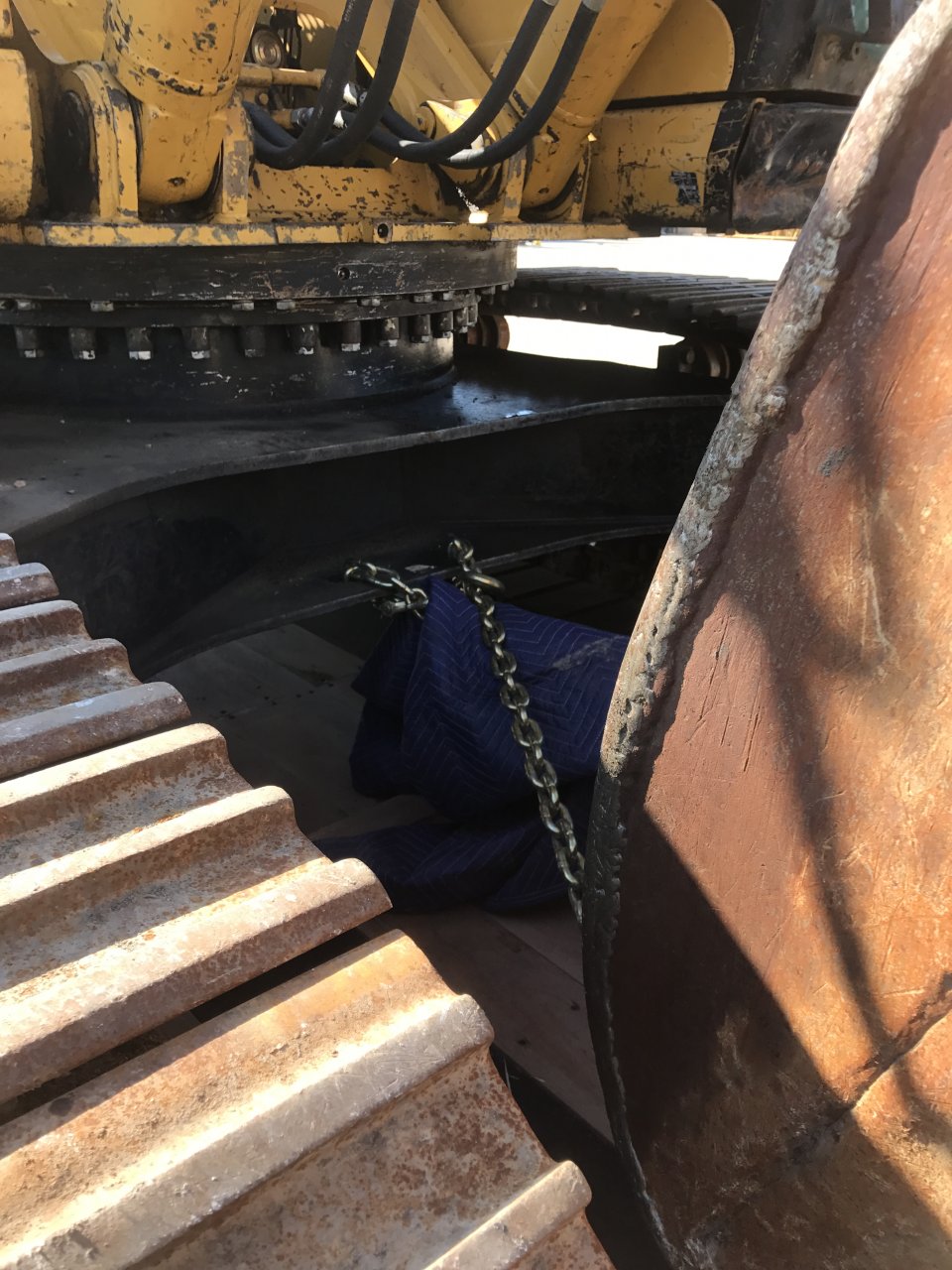

    This is true also curl the bucket more if you can, that dogbone will get closer to the stick and getting your height down if the thumb will let that is.

    Took a minute but I understand what you said now. Thanks

  5. noluck
    noluck Road Train Member
    1,616
    11,683
    Jun 10, 2011
    greenville,sc
    Looks like you pretty much got it. I would curl the bucket all the way in and lower the boom all the way down. I carry a piece of rubber from a hay baler and put between the boom and rear transition if need be. Then chain Over the stick. Don't forget to cover the exhaust!!

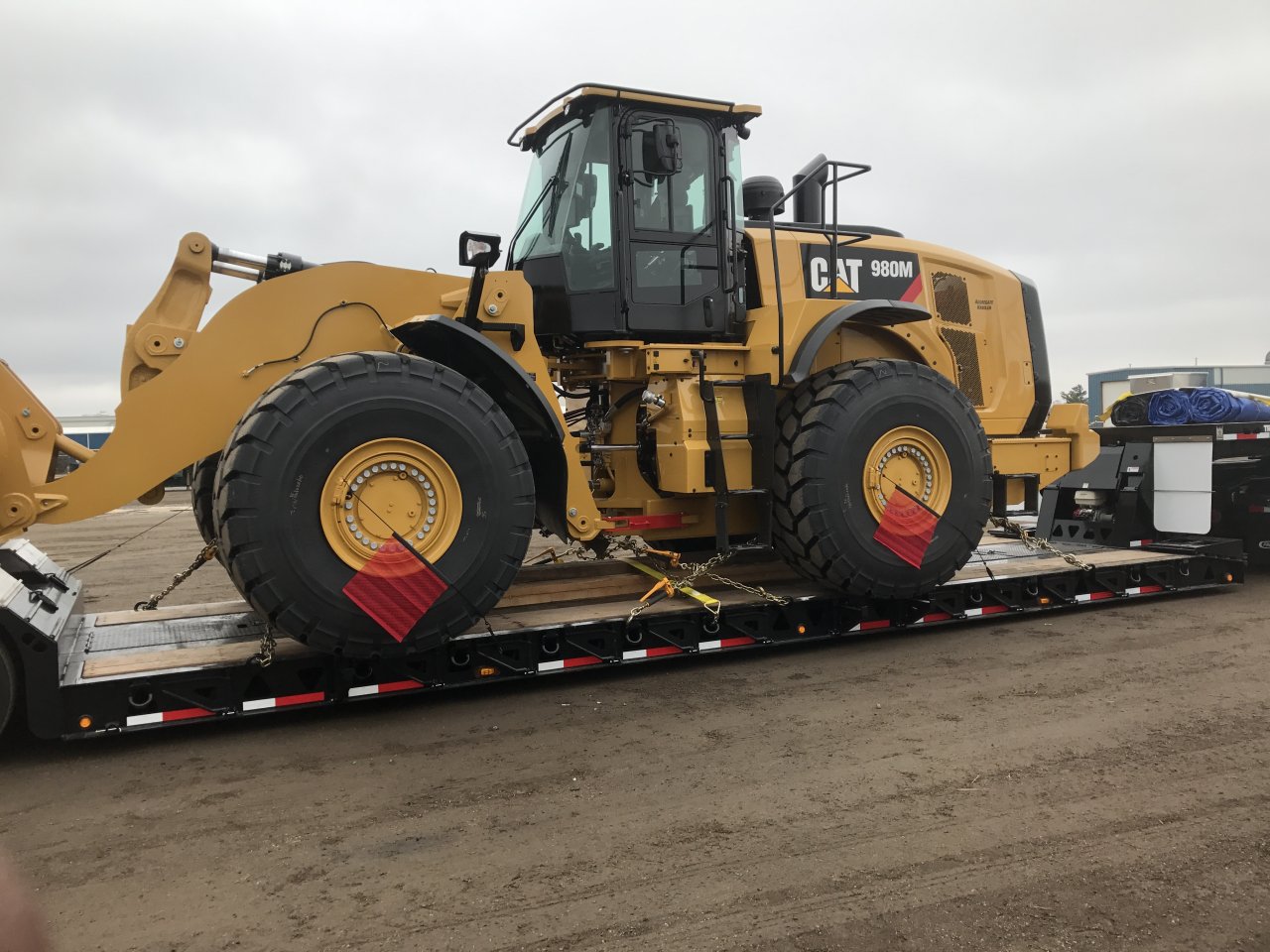

  11. Big_Red
    Big_Red Medium Load Member
    439
    989
    May 5, 2011
    Not active
    Here's today's kill. This one actually gets to stay on lol IMG_0863.JPG IMG_0853.JPG IMG_0855.JPG IMG_0856.JPG IMG_0857.JPG IMG_0859.JPG IMG_0860.JPG
