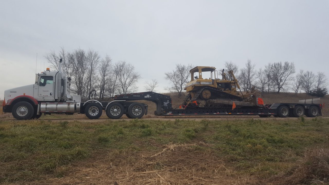

    Better keep this thread on track. The picture of the D6H loaded forward was at the dealer, blade wouldn't go up on its own, lifted up with a 160 and did a little dance backing it onto the trailer.

    2016-10-23 12.51.02.jpg 2016-10-23 17.51.42.jpg 2016-11-07 09.51.32.jpg 2016-11-17 09.46.27-1.jpg 2016-11-17 09.46.40.jpg 2016-11-17 09.47.12.jpg 2017-02-16 09.45.51.jpg 2017-02-25 14.45.22.jpg 2017-02-25 14.45.45.jpg

    All looks pretty good, but the only thing i wonder is on that last pic, i wonder if the MAN would bust your arse over those mud flaps. Not saying he would or wouldnt.....i just wonder what theyd say if you ran into the wrong one.
    What do ya think?

    Looks like plastic flaps that got bent up when somebody detached that flip and let it rest on the rear bumper.
    I would probably let them ride if it were me but I don't pay for my mudflaps. I could for sure see a DOT guy in a bad mood using that as a reason to write a ticket if he couldn't find anything else.

    Actually I just noticed that it doesn't have a rear bumper. How is that legal?
