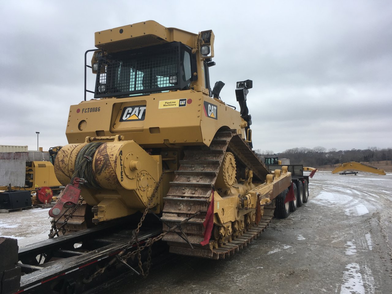

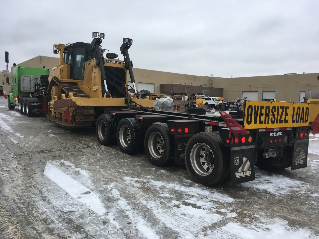

    Loaded up in Omaha waiting for permits so can get moving IMG_3048.JPG IMG_3046.JPG
