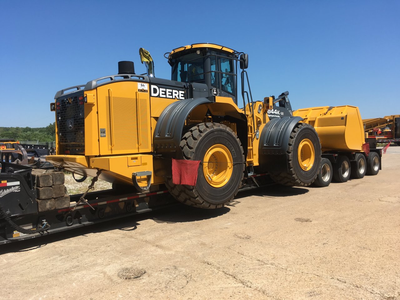

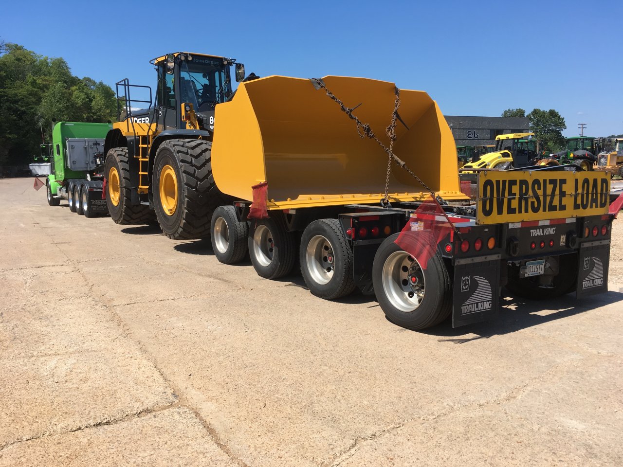

    Loaded this up this morning in Fenton, MO, bound for Albuquerque IMG_5818.JPG IMG_5819.JPG
    Pipe 40, Old Iron, truckdad and 18 others Thank this.
