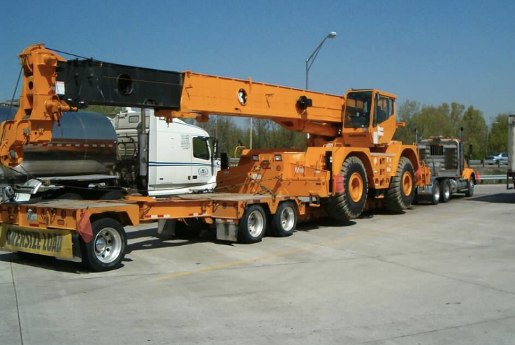

    What’s the next size smaller trailer weigh ? Would that be considered a 45 ton trailer ??

    You could go 50 ton and might lose a little weight. You can also lose a little weight by running a mechanical trailer but I wouldn’t go back to one.
    45 ton trailers tend to be 2 axles with a flip and top decks that tend to make them almost as heavy.
    In my opinion, when you need the trailer rating to do the job safely, the trailers are all “heavy”. How heavy depends on the features you need...well length, neck length, flip neck, 8 6 wide 9 wide 10 wide
    Most of the 7 axle guys are going to be around 50-57k with some a little lighter and some heavier. I am 65k as a 6 axle with my truck and just the trailer portion
    Feedman, SAR and cke Thank this.
