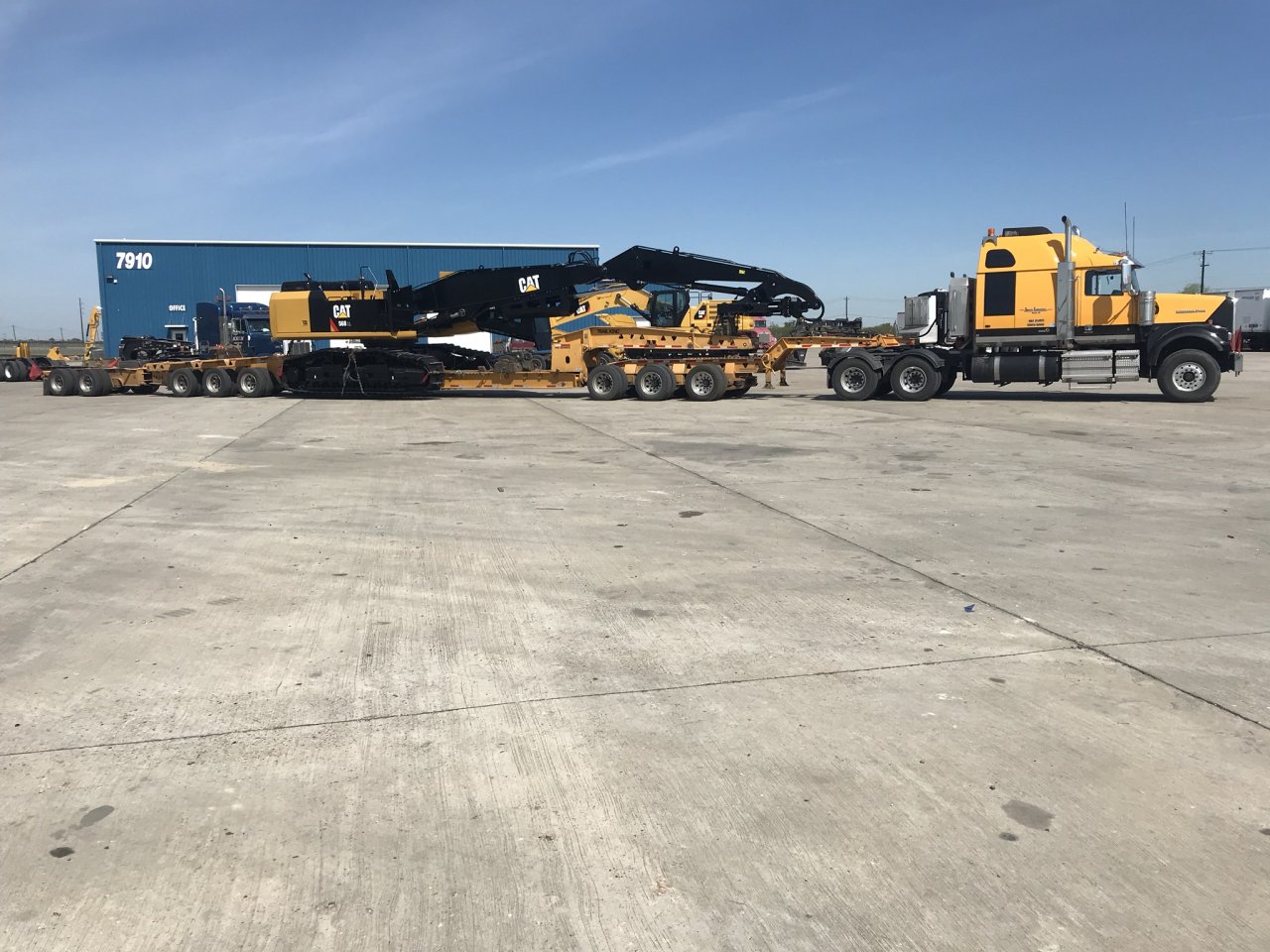

    Maybe one if the uglier machines ever made. 118L 12 w 190k
