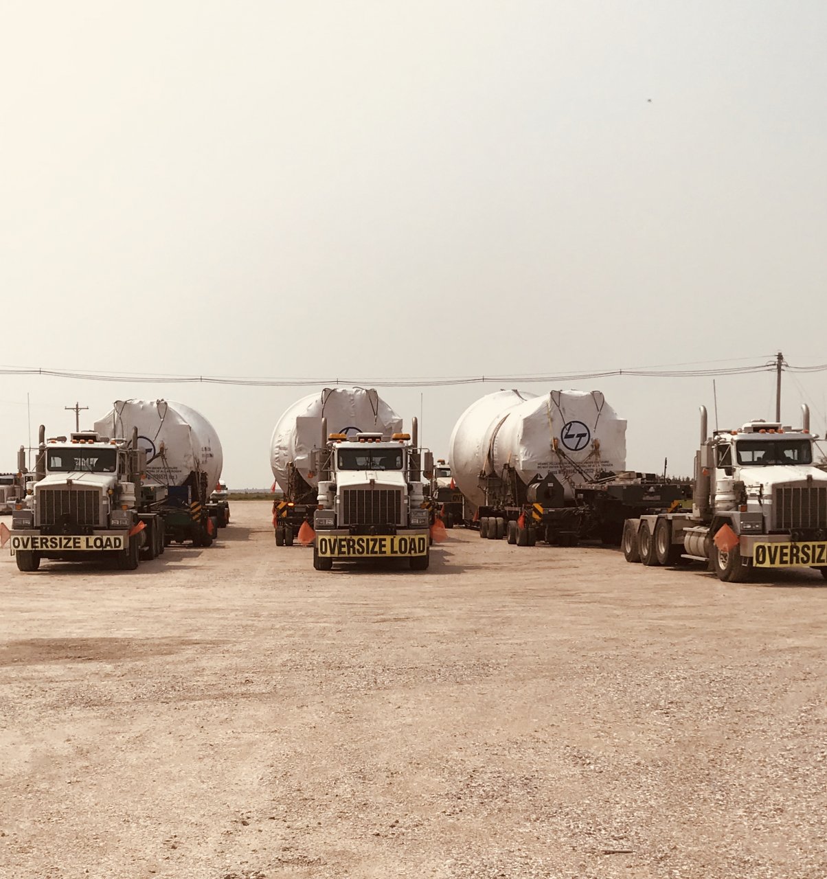

    For weight, they were a little over 27,000 each.
