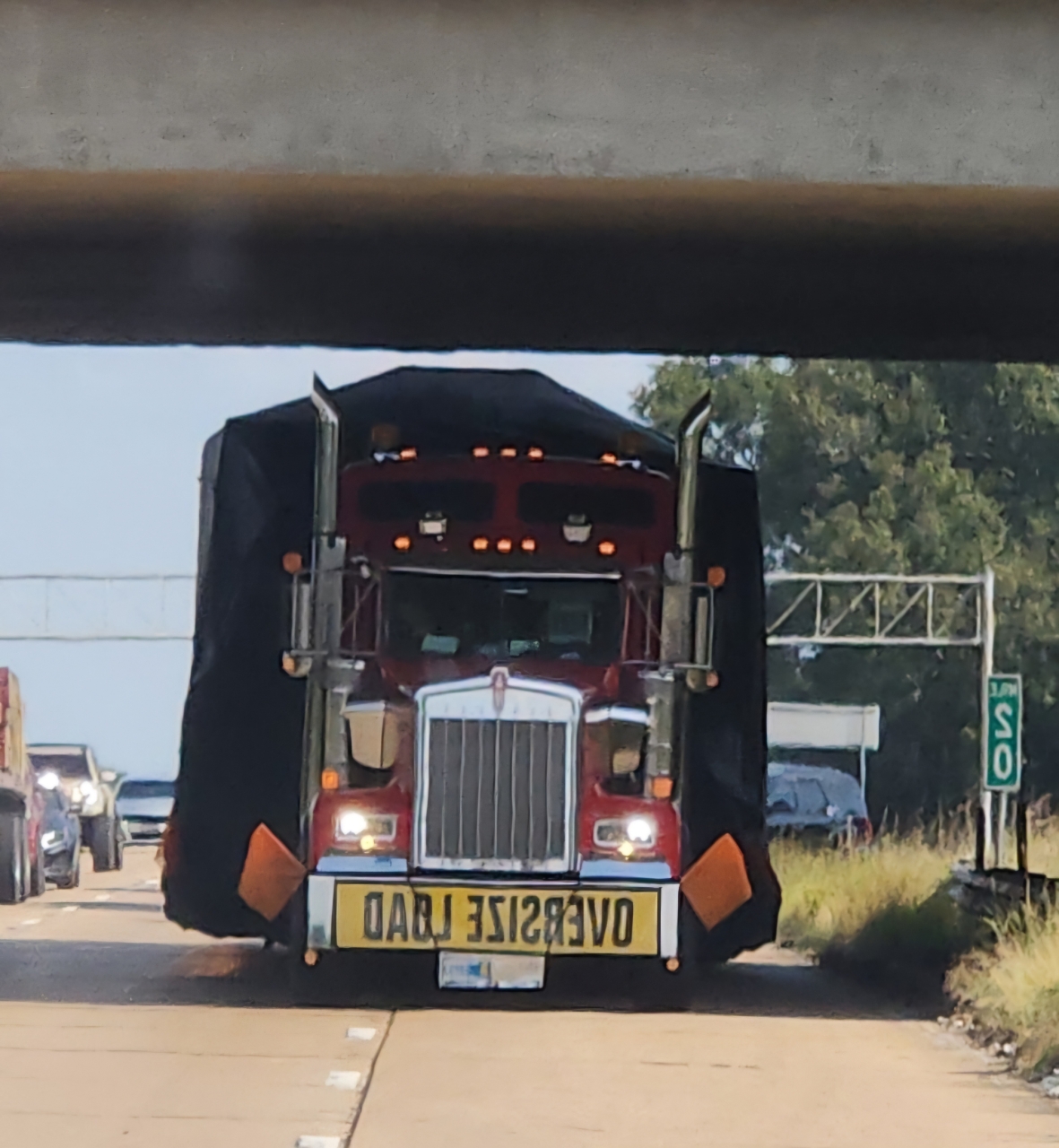

    When you’re on route and have to stop traffic on the interstate so one can crawl under a bridge.
  11. Razororange
    Razororange Road Train Member
    2,528
    24,191
    Dec 20, 2011
    Milwaukee, WI
    I had to do that on I24 south of Chattanoga last year for 3 bridges in a row. They even sent us the drawings and we had to go under them left right left in under a mile. 3 loads and 9 pilots. We ####ed up traffic that day. Almost had one of my pilots get hit by a ####### in a KW who cut around us all because he was impatient.
