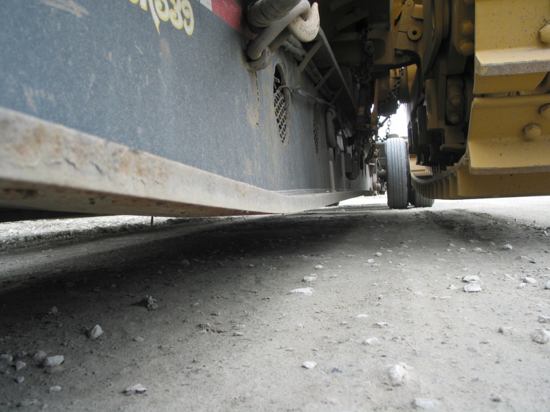

    Yeah, you have to use enough drive on blocking to make sure the machine is high enough to place the correct amount of blocking on the rail/under the machine to provide proper ground clearance...but not too much that you cant lift the machine off the drive up blocks. I use 12 x12s & they almost always provide adequate clearances. The blocking that supports the load had best be good quality hardwood, as this is all you've got holding that machine off the ground, it's a bad very day if your blocking is inadequate! When you have it all blocked, lifted, and the frame portion tied down, don't forget to put in a set of track pins to take up the slack in the tracks, or they'll probably drag on the ground.
    Depending on what your hauling you had also best make sure you have a well built trailer, cause you are usually concentrating loads in fairly short lengths of the trailer...ie; a 109,000# 349 Cat excavator, or a 110,500# D10 is blocked on hardwood, sitting in approx 4' of length on that rail! T100 or T130 steel is your friend, beware of lesser grades of steel or your gonna bend it good.
    This is a 349EL Cat excavator, weighing just over 109,000 (payload) that sits on a 4'3" span in the center of my trailer with 30' of well, that doesn't include the neck or transition length, so it basically plunks 109,000# in the center 10% of the span from kingpin to coffin mount!

    oh yeah, and the best advise I can give is...you had best tie it down well, cause you don't have the friction of the tracks on the deck to prevent movement, this one is all on you!
    This is a D10T dozer weighing just over 110,500# (payload) sitting on a 4' span in the center of my 20' main rail...the last pic is a different load, still D10T, just had the tracks removed because the destination had gross weight bridge restrictions. I can't find any good shots of a 10 with tracks on it...
