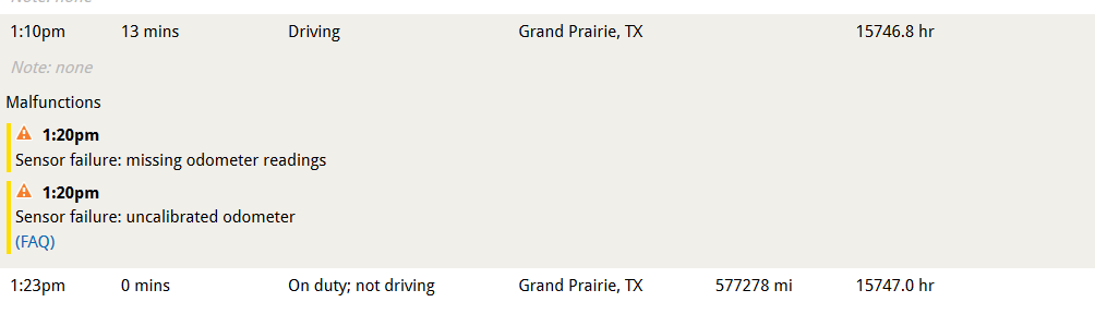

    Some pics what is going on
    Screenshot-2018-1-5 BigRoad - Person.png Screenshot-2018-1-5 BigRoad - Person(1).png

    That's what I was referring to in my earlier comment. I've had that same Sensor Failure:uncalibrated odometer reading a couple of times. However, it only last for like 1 to 5 minutes on the log itself.
    When I've gone back and looked at the accuracy of the odometer reading at the beginning of the day and the end of the day on the log itself, it's accurate.
    Therefore, I just don't even worry about it that much at this point.

    Odometer accuracy is another weird issue. I have some days with over 600 miles run and odometer was off for 1.5 mil. Yesterday i did test run with mechanic 68 mil and odometer is off for same 1.5 mil. So nothing to look in tire size rev/mil. Something is weird.
