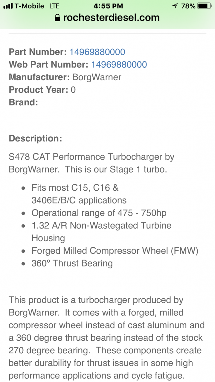

    Borg Warner does now have a direct bolt on which is the stage one. You have to look for the number. I bought my in 5 pieces including the clamps. It was less expensive. Under $1500.00 if I remember correctly.

    Posted this for a reference number above

    any borg warner supplier should be able to get ahold that stage one turbo right? because that is just a 175693 with a 1.32 housing.

    I’m surprised others have not chimed in yet, maybe cuz of the holiday. And to answer your question, yes, any turbo supplier or Borg Warner distributor should have it. Like I mention earlier, they do sell it as a whole now instead of buying in sections. Shop around. There are many suppliers.
