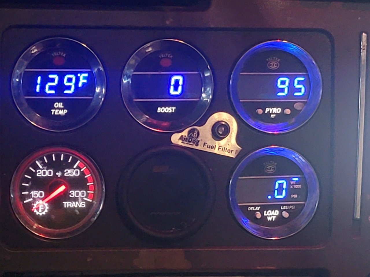

    So teltek makes smart gauges now. They get the reading right from the ecm and they are digital. I have 4 different ones from them in my dash but will be adding couple more. I seem to have lost my transmission gauge when we moved lol
    SMART GAUGE BOOST
    Down side you probably have to use ESA to turn it on to read it. It's a 50/50 chance if it's already turned on or not. 20230121_130810.jpg
