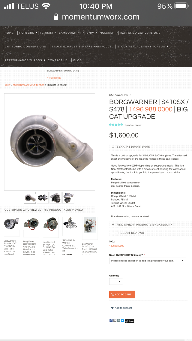

    A6844AEC-667C-4A16-8DF1-C169558B5583.png Hope all is good guys, I’m turbo shopping for my 3406c mech and I know the boys all say the s410g is the way to go but the guy I spoke with at momentum works said the s410sx 78/1.32 would be a much better turbo. It’s non wastegated. What do you guys think. I’m running everything stock but will be turned up to specs in forum proper to be around 530-560hp. I was dead set on the s410g till I found this one and spoke to Momentum works. I’ll post up the turbo.

    I bought this one about 2 months ago. It didn't make that much more improvement. It will save you $600.

    Ya not interested in changing my turbo for no improvement...

    The bigger the turbo you buy the more turbo lag you get starting out, but more power as soon as it get spinning?

    He is trying to sell you a charger you dont need.
    A borg 177148 which is a410g is one of the best chargers for a working mechanical.

    That’s what I figured. Pretty pumped to throw this s410g on with the turn up. Thanks for the info.
