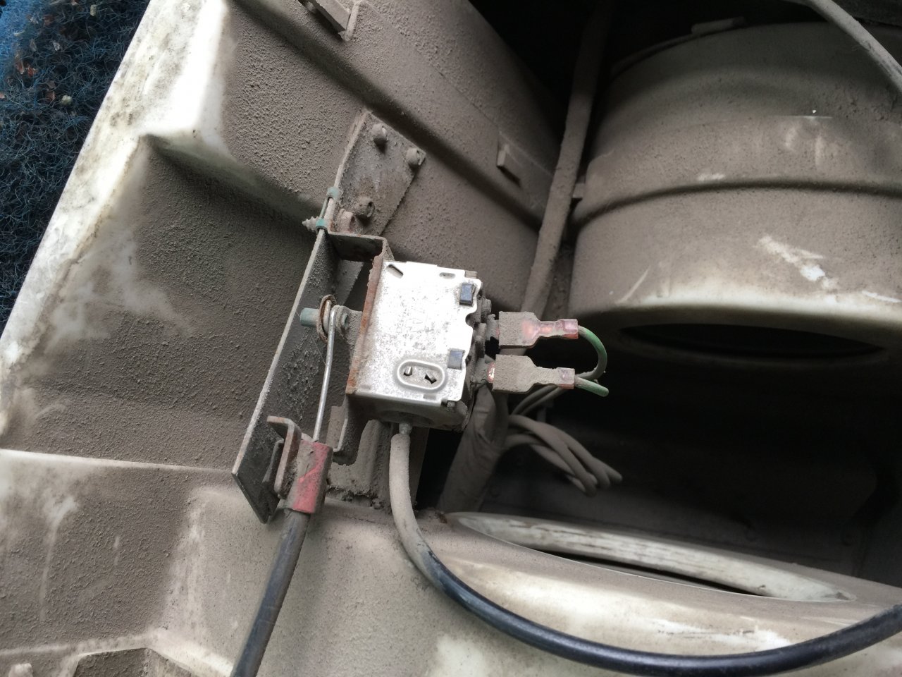

    So that upper slide control on the dash that says a/c is the only thing that engages the a/c compressor.
    It does not do anything when I push it away from off on the right to ac on the left even though I can feel a drag on the control cable.
    Most likely the a/c is low on freon and my gauges are back in Florida.
    I can manually jump the a/c clutch if it stops raining
    Need another person here to locate air dump for fan.

    I can see the relay moving in the heater box underneath the passenger seat. I jumped it still no a/c.
    Probably low on Freon. Next week jump at the compressor and get to the bottom of the fan kicking on.
