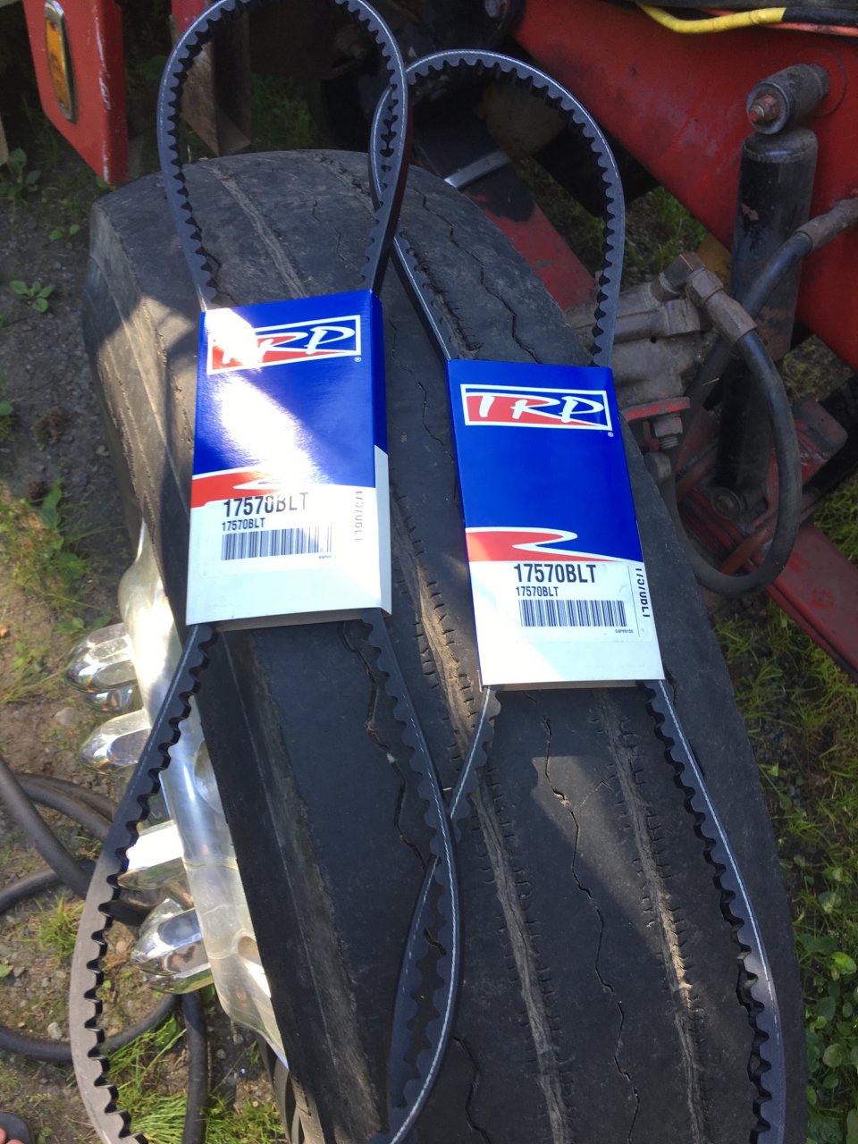

    I went down to my local Peterbilt dealer and got these. They seem to be of good enough quality, and are much better than what was on there! For the record the part number is: 17570BLT
    I wrenched for about 10 minutes and had the belts nice and snug. They look great!

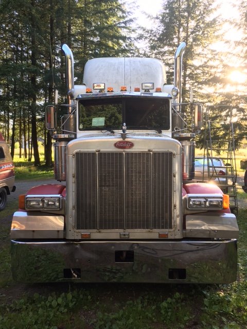

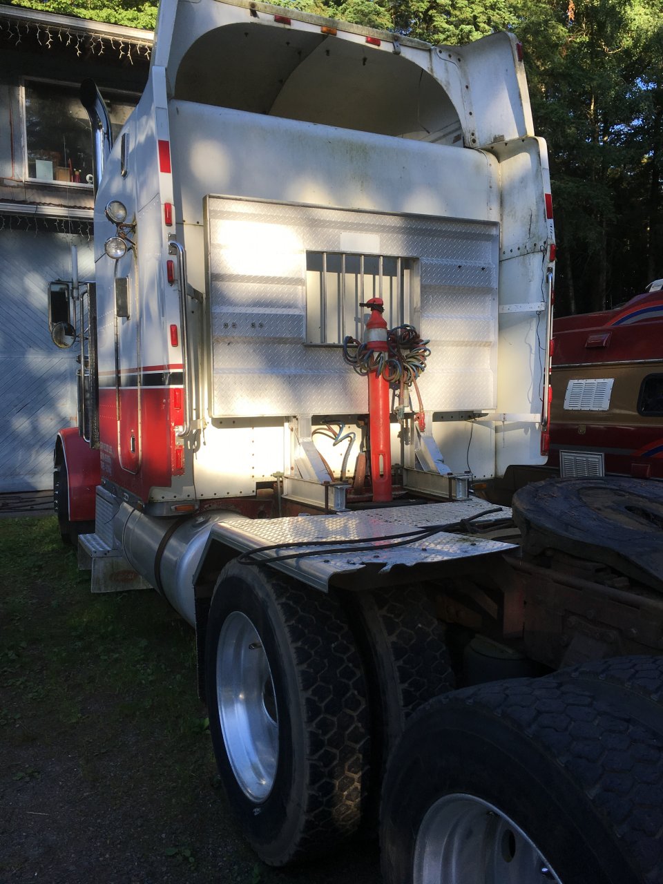

    @Diesel Dave I took that speedo pic a few days ago when I was out there last. It was that and the vin. Here are the rest of the pictures, and yes, she does need a bath! Now, the work begins, and I will be needing lots more input so please keep it up. I will update as often as I can. IMG_0367.JPG
    I was able to get the truck up and running today and then across the county to my place. It is out in my yard. I did notice a few things, like lights and a few other small things that need to be addressed, so I got those things ordered up.
    Next is to dig my lowboy/RGN out of the shop. It is buried in the shop with all kinds of random stuff sitting on top of it. Its a pretty big job, but I can wait to hook it all up! Stay tuned and, as I mentioned, please keep up the input. Any help is greatly appreciated!

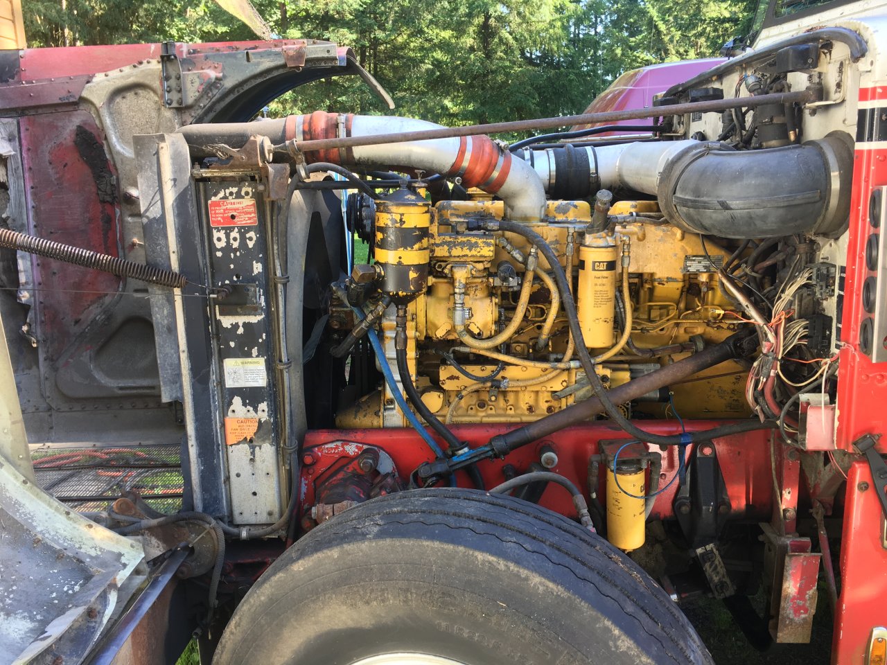

    Here is a pic of the ol' Cat.
    I did notice that I do have several hoses to replace. I haven't been able to clean up inside the engine bay yet, but I think I may be able to get to it late this afternoon.

    If it's been sitting a while you may want to change out the quad seals in the timing advance. The diaphragm in the Afrc. They tend to dry out over time. What ever you do, don't completely remove the screws out of the pump. No matter what turkey tells you too.
