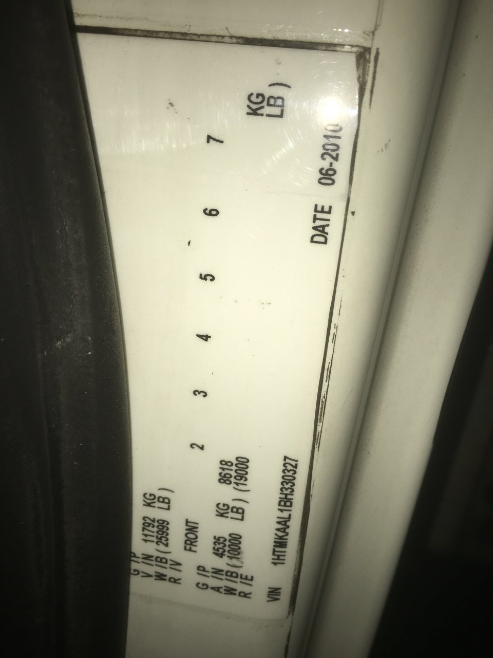

    My truck weighs 17k empty...
    The GVWR is 25,999
    The GAWR is: 10k front axle & 19k 2nd axle
    With my 2 axles (GAWR) able to handle 29k, is that irrelevant to the 25,999 GVWR?
    Attached pic if it helps.
  11. x1Heavy
    x1Heavy Road Train Member
    34,017
    42,132
    Mar 5, 2016
    White County, Arkansas
    I don't know.
    What year and model is that thing? Maybe going to the factory manual we will know more about it.
