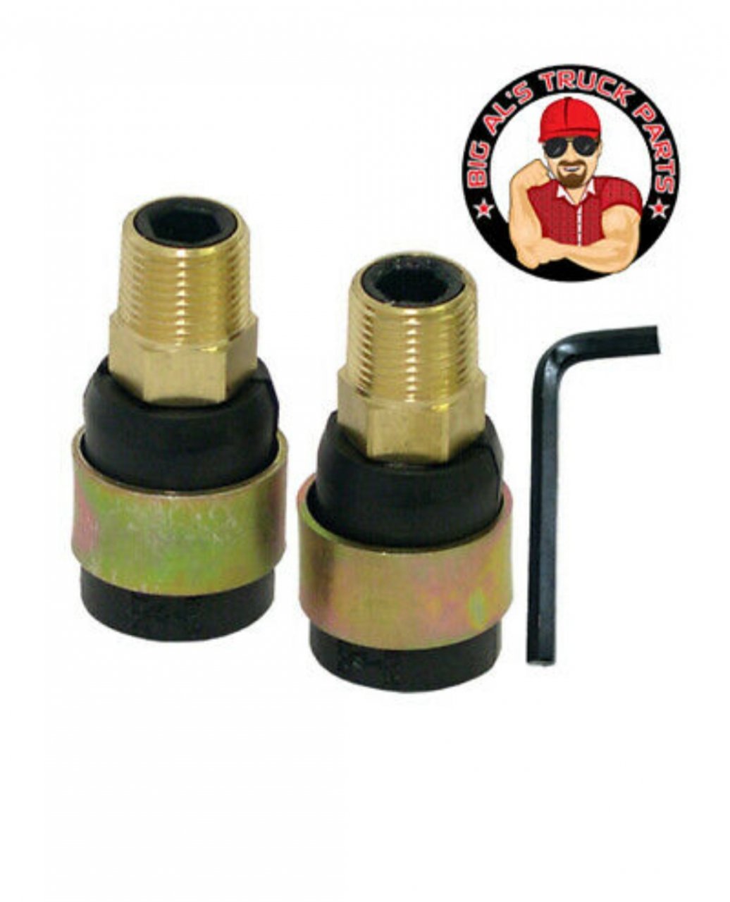

    Good in a jam. There’s 2 sizes. Get the right one. A splice/repair coupler onboard for emergencies is also good. Anything that avoids

    My guys tease me that I only have them on trains so they can pack all the spare parts I’ve got them lugging around. My parts supplier had a air line emergency repair kit he brought out here to show me. Good common sense selection of fittings and compression unions to attack any size airline on the truck. Synflex or rubber. I bought 7 so they gave me a bit of a break, I think they cost me $150 a truck. Wouldn’t have mattered if it were $200 a truck. The first time one of them tore an airline off a trailer in the bush more than paid for all of them. GDX Kit9 is what they are.

    Too many recommendations to quote them all. But I'm gonna call frieghtliner and see if they have that kit. It's all I need.
