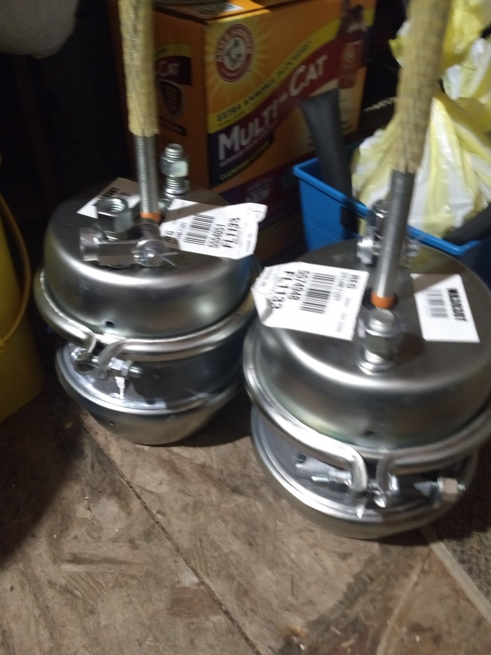

    That's why I replace the whole can instead of dealing with doing the diaphragm.
