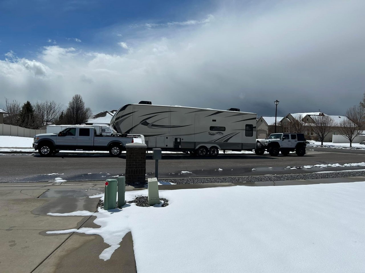

    I flat tow my Jeep behind my fifth wheel all over the place with no brakes on the Jeep……would tow it coast to coast if need be just like this.
