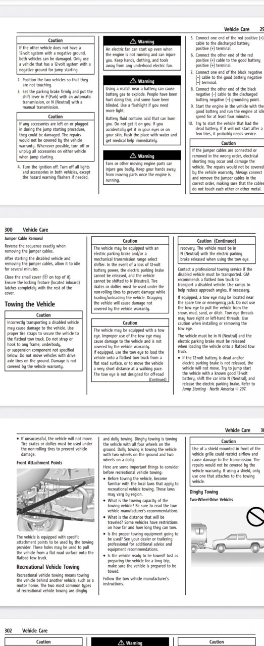

    also need to consider if the Colorado's steering wheel locks once the (steering) wheel is turned

    It says Dinghy towing is not allowed. Didn’t say anything about Dolly towing being prohibited.

    The manual contradicts itself a few times. And makes you flip to various sections.

    You WANT the steering locked if you have the rear wheels on the dolly and the front wheels on the road .

    Oh
    yeah , they are definitely loud when empty but can’t do anything about that .
    last time I used one was behind my 4 runner to go pick up a suburban ,
    When I got the burb I just put the dolly behind it and towed the 4 runner back , I put the rear wheels on the dolly and made sure I had the fronts streight and locked em .

    correct, but not if flat towed as was also being discussed

    Flat towing an automatic trans vehicle is usually pretty expensive .
    unless you leave the engine idling and the trans in N .
    I’ve seen that done several
    Times
    seen a few people do it with manual trans vehicles too .
