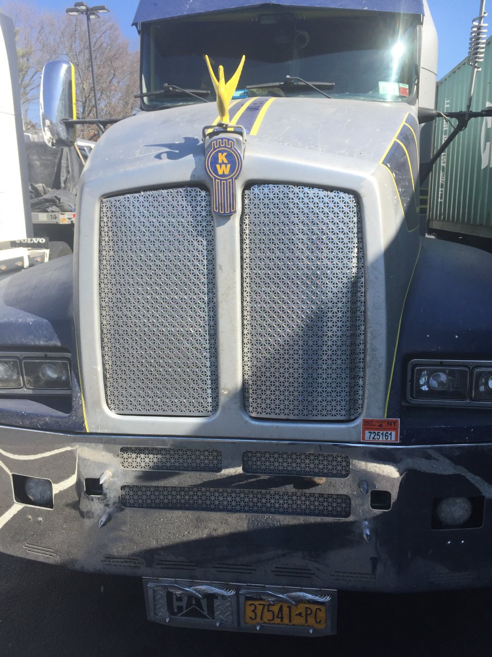

    Also put the new grill in to protect new radiator could that be restricting air to much

    I would say it's a combination of both. I tgink the grille needs to flow more air myself. Plus the more core's a rad has in it the harder it is for the air to get through without the fan sucking it through. Especially at low speeds. At highway speeds its not as noticeable but that grille isn't helping there. How hot is it running?

    I would loose the grill, looks like it covers about 50%, same as having a winter front half open.

    Gotta agree with the above. A properly functioning tstat will regulate the engine temperature. I bet you'll see a difference on a long hard pull. The grill could be causing a restriction but I'd keep it on for now until you do a few hard pulls and see if the bigger rad is working.

    I agree. Go back to a stock grille and put a bug screen on to protect it.

    Thats all I have on mine as well. Stock grill with a bug net behind it.
