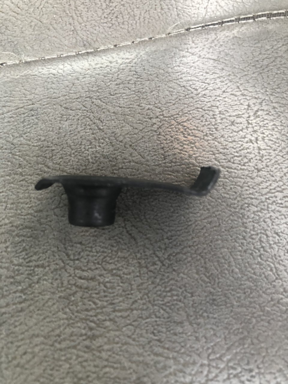

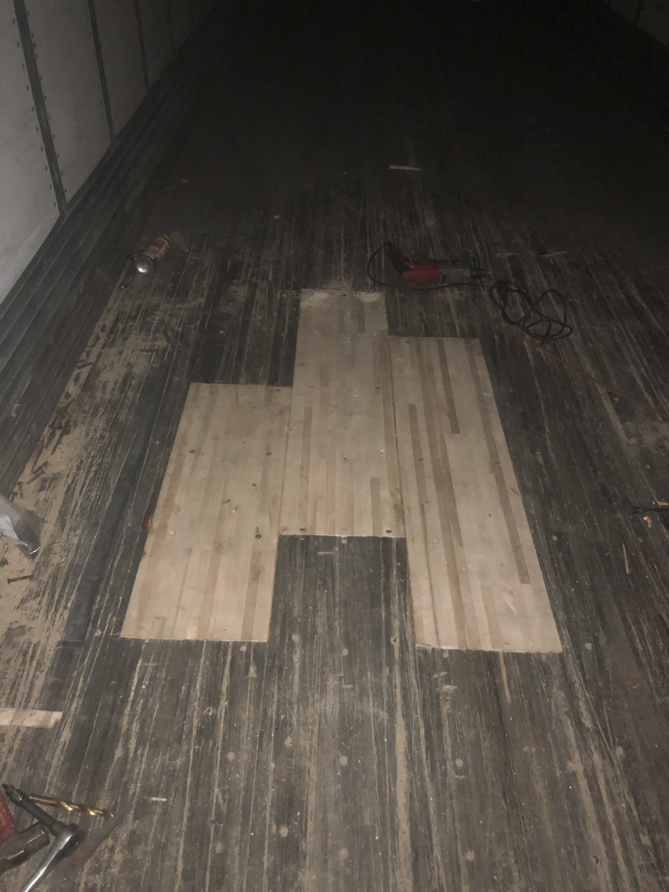

    16174330-0CC6-45C4-B1ED-9D828A61DC7B.jpeg 55B0FFBA-742C-44B8-95B8-006A37597BDA.jpeg 367E145F-F4A7-4CAA-B809-5A9D5B1B7EC3.jpeg I replaced some on my dry van. Amazingly, I got them all out. Used a 1/2” drive hand socket. PB and working them back and forth. What I did for the tough screws, is cut the wood out, with a circular saw. Cut close to screws, and cut in between crossmembers, then pound wood out, leaving the screws in place. then pb blaster.I had to cut a few off a 1/4” die grinder and knock them out. I’m sure some heat would really help. The few that were stripped and wouldn’t tighten up, I put fender clips, broken in half. Handy if working by yourself. Or a lock nut will work. They’re going to rust up good anyways. Hardest part is keeping the touge and grooves intact on old boards. If they’re T$G. If you’re crossmembers are aluminum, though, I’m not sure how that would work.
