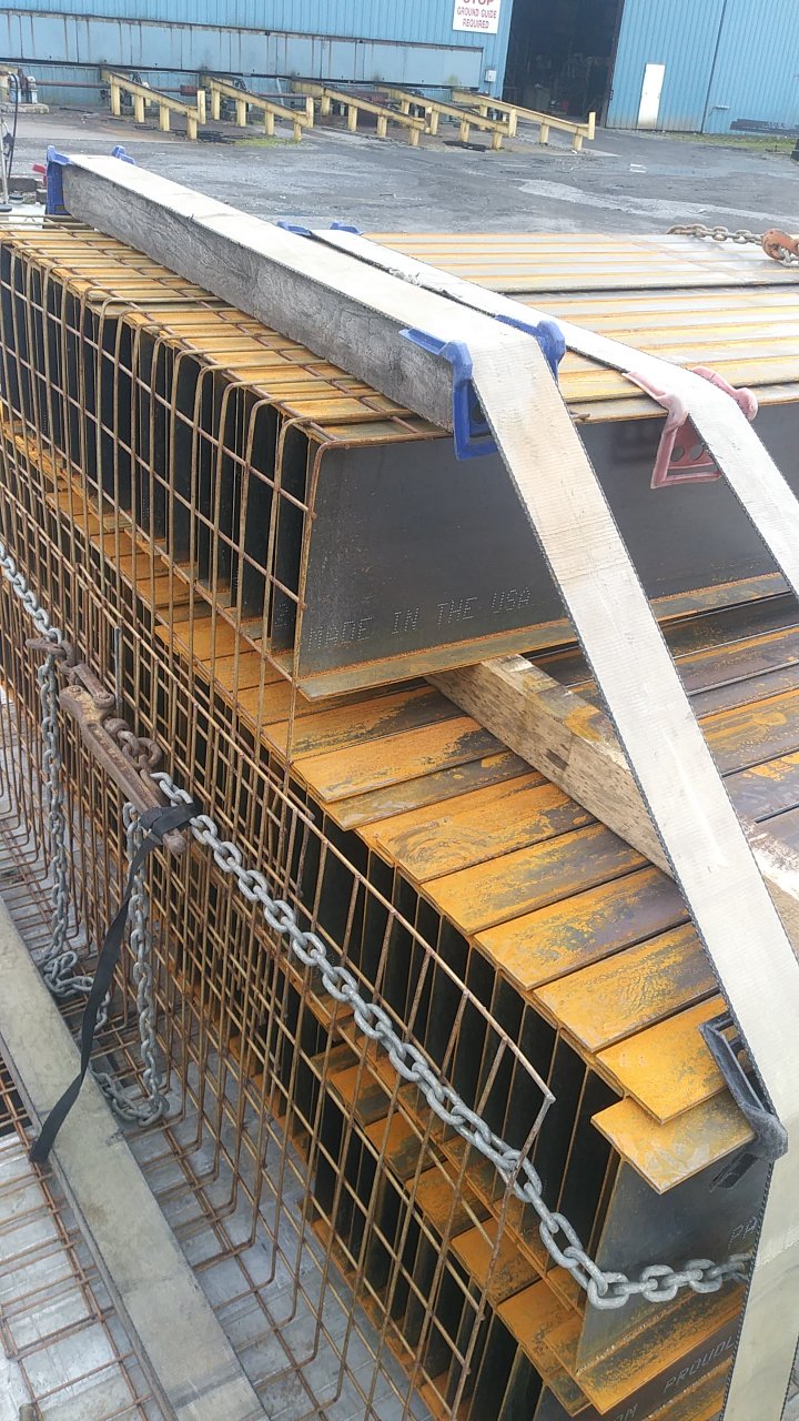

    I started off with just straps, firehose protectors and an old 4ft tarp but had fallen bricks try to come out, so i added a rope belt around the bottom to retain them and a steel brick lintel over the top to use less straps and bind the whole load more evenly.

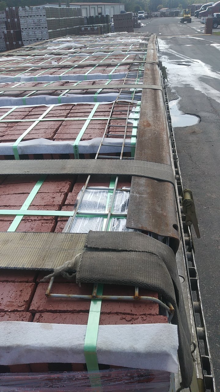

    Then i started rolling up a 4" strap and hand ratchet along the rubrail, into the tarp to make a sideboard of sorts, like this. It was much stronger than rope. I couldnt lift the tarp off the deck. Theres one on each side.
    But it all took forever compared to the guys with brick screens, theyd be out an hour before me. I was just missing the same day unload cutoff a lot and it was really eating into my pay. Brick was about 50% of my backhauls when things were normal.
    So the next move was used pallet racking with the braces knocked off, and having them bent in a pressbrake.
    It was better but we still needed edge protection. The wire elbows would pop through a bare strap, and the strap would bend the screen which made them hard to stack. So i tried screens and lintels. Yeah it worked great with bare straps but its a lot of time and tare weight and walking trips to put all away. I could only carry 2 screens at a time without sheering a finger off.
    Then i found some plastic corner beads tossed next to a dumpster. I cut them up and zip tied to each screen for a full length edge protector so i could leave the steel lintels at base. They were hard to fish out of the dunnage rack and i was tired of them on the deck.
    It worked great a few times but wasnt tough enough long term. If i really bind down the plastic corners would crack or break the zip tie and peel over. And i could still tweak the screen if i tightened em good, especially since unpalletized brick edges rarely line up between packs. This is how i gave them back when i quit.

    I forgot to add that i prefer to try to turn 24 packs of brick into one single unititzed mass for the sake of DOT by over lapping my lintels or screens and strapping right over the lap joint. You can see it in the pic with screens and lintels.
    I never saw anyone do this with screens .. Theyd put one screen over two packs with either one or two straps. Totally secure but what does the new trooper with something to prove say about it? I dint want to leave room for being hassled.
    I never wanted DOT to say you got 24 packs you need 13 straps plus 26 edge protectors. I was always looking for ways to build it into a solid block that only needed enough for 47k and 30ft or whatever it was.
