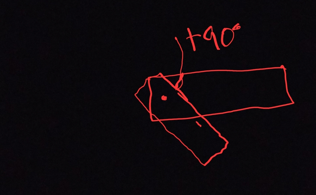

    Im crapish at backing, how far over 90 degrees do i need to be to bend my fairings? Hint, its quite a ways, ive been cut so far trying to turn around before that i could see my trailer tturn signals by looking straight out the window, not the mirrors
    As near as i can guestimate, ive got to be close to 135 degrees (45 over 90) before i need to worry about it, but at 90 im already playing with my air lines to make sure they dont snap or snap gladhands... far cheaper than a fairing, but much more annoying to mess with when youre dead in the water.
    At this point, going forward (straightening) means your trailer goes backwards, and vice versa, its an unpleasant experience
