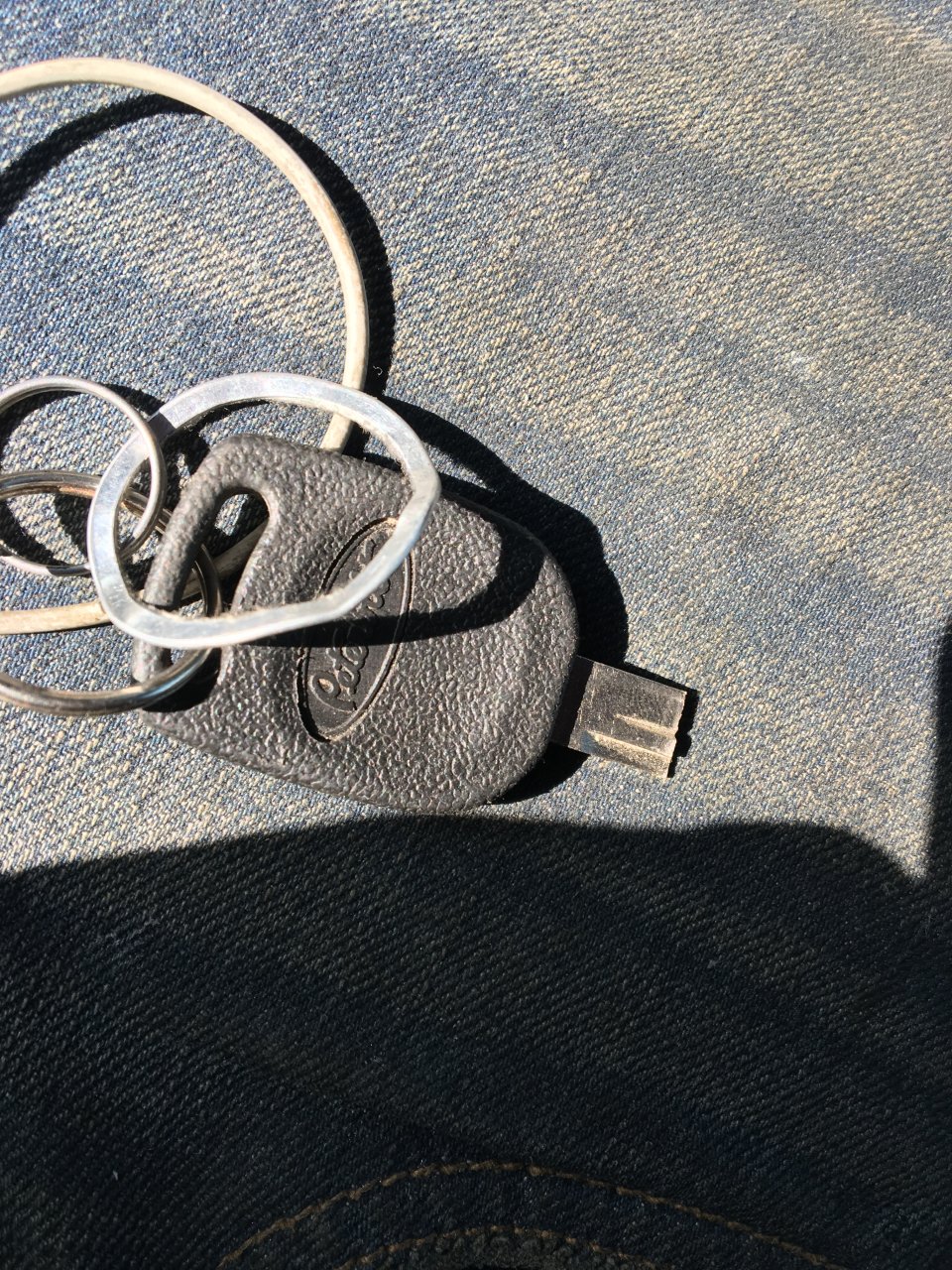

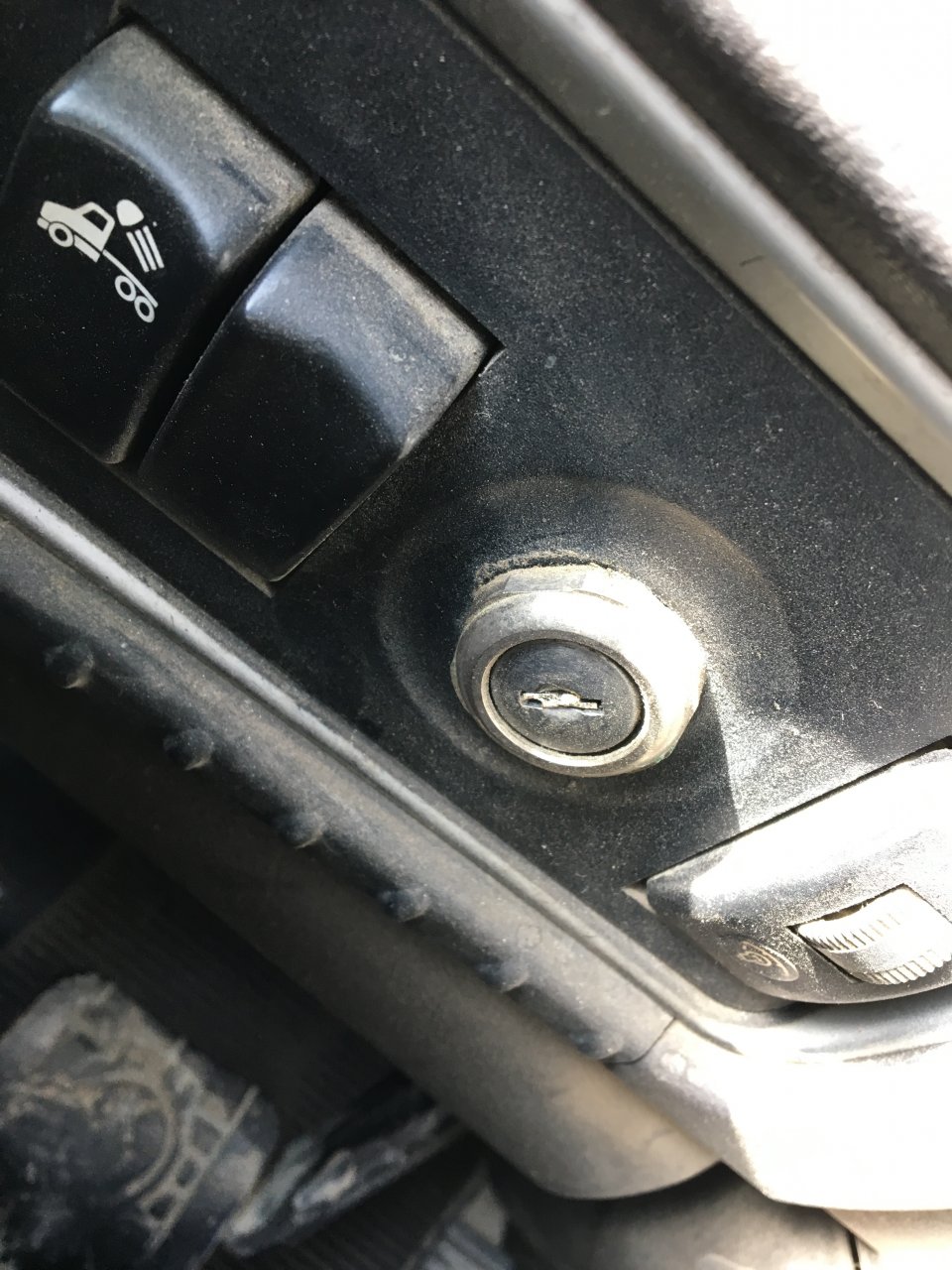

    Accidentally broke my key in my ignition I’m in the middle of nowhere in slapout Ok i can turn the key to the on position but I can’t turn it enough to crank is there another way I can get truck running ???

    If you have a pair of tweezers in the truck, that might work.

    screw driver.
    If you can turn the key to the run position. Then hotwire your starter.
    Connect a hot(positive) wire to your starter solenoid where your ignition switch terminal is. Small screw. Just touch the hot wire to the screw until truck starts then remove. If you leave the positive wire connected your starter motor will continue to run. That is not a good thing.

    you might be able to pop off that cap inside of the locknut. (where we can just barely see the key)
    once you do that, you'll have more access to remove that key
