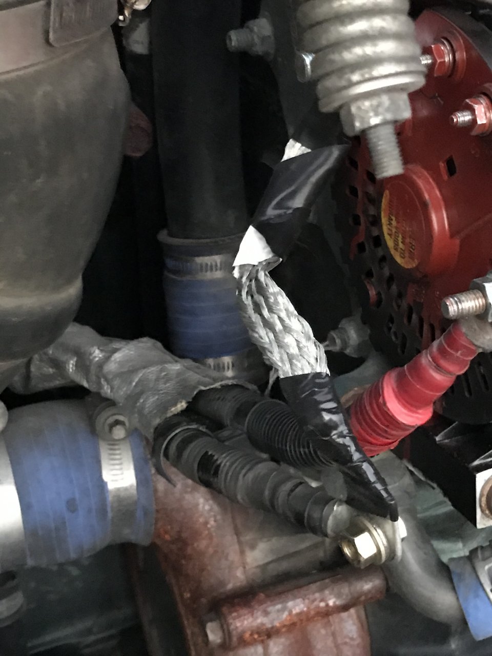

    All fixed, what I ended up doing was taking it to Alternator shop and he correctly replaced the post. Although he had to put a bigger post in there because the lil shop across from where I park at tried to do this and used a drill to big. So then I had to redo the alternator wire. Instead of cutting it and putting a new/bigger post/lug on there I just bought one of those flexible wires and ran it to the alternator wire...Ill take a picture of it tomorrow.

    I'm real curious what this flexible wire fix is?
    Don't be scared of wiring on the truck. Its all pretty simple and as an owner operator I think it's a necessary skill. A good stripper, crimper a heat gun and heat shrink butt connectors and you can fix a lot of stuff

    I would've made it too thin. Ill post some pictures

    Ill post some pictures this morning before I head out to pick up. If I forget ill post when I get back home this afternoon

    That "flexible wire" is called a "ground strap"
