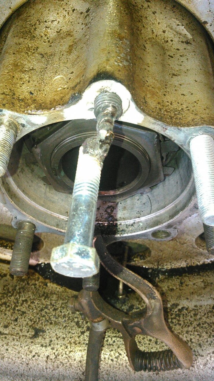

  9. BoxCarKidd
    BoxCarKidd Road Train Member
    4,551
    6,641
    Aug 26, 2014
    If I planned to run a little I would make sure the the others will tighten to spec.
    This is one I did. The distance from the end of the bolt to the broken stud is how deep it was broken off in the hub. Tried a drill and easy out first. KIMG0319.jpeg Spotted with a stainless rod over and over. Then welded to the bolt.
