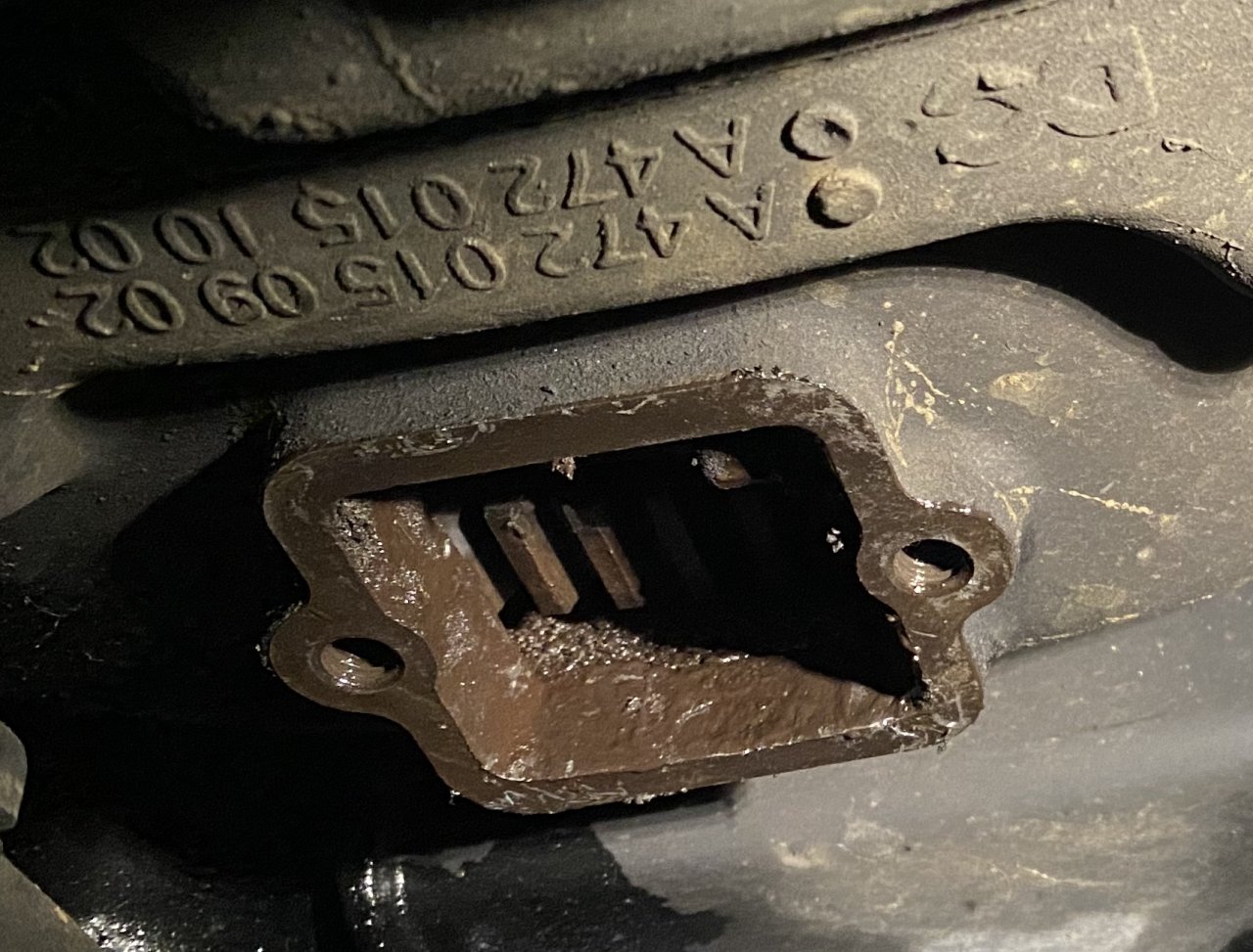

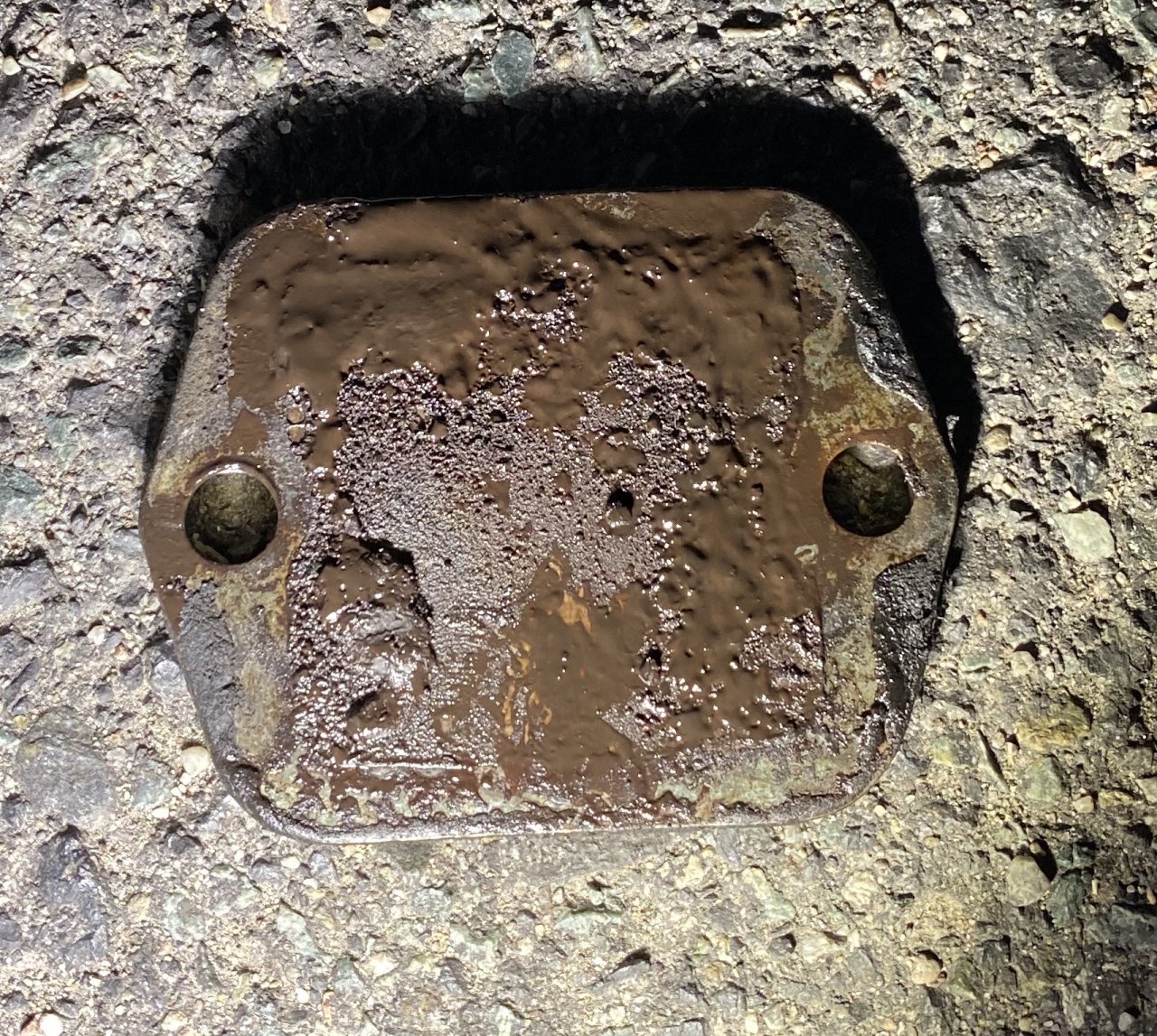

    This is the small cover directly under the flywheel housing on a DD15 engine. Is this brown substance normal, or could something be leaking?

    clutch dust and muddy water maybe

  4. AModelCat
    27,739
    145,364
    Does it smell like oil? Feel oily?

  5. Goodysnap
    Goodysnap Road Train Member
    3,502
    8,384
    Jul 12, 2017
    I would agree with clutch dust. The big question is, what is it wet with?
    Coolant? Diesel oil is ussually darker or toward black so it doesnt look to be engine oil. Water is a possibility but the combination of engine, trans and clutch heat should keep everyting dry for a truck under normal on hwy use.
    The other possiblity is trans oil?
    Hydraulic clutch? Brake fluid?
  6. PE_T
    PE_T Road Train Member
    I don’t think it’s engine oil and I don’t remember it smelling like oil, but perhaps it’s some other kind of oil. There is no leak, though. This is like some sort of paste, maybe grease.

  9. AModelCat
    27,739
    145,364
    I was thinking more along the lines of a weep from the input shaft. Looks a little too juicy to be seperating grease from overgreasing the release bearing.
  10. Motto
    Motto Light Load Member
    102
    125
    Apr 10, 2020
    clutch dust plus grease from bearing...

  11. baha
    baha Road Train Member
    4,137
    2,834
    Jul 25, 2013
    ga
    It just looks like it has/not been cleaned for a long time and grease from throw out bearing over a long of not pressure washed under truck, trucks with side panels make it hard to clean under trans. take a bent screw driver and scrap out what you can get out of bottom of bell/housing, don't shoot cleaner on pressure plate that can get in springs and make plates slip?
