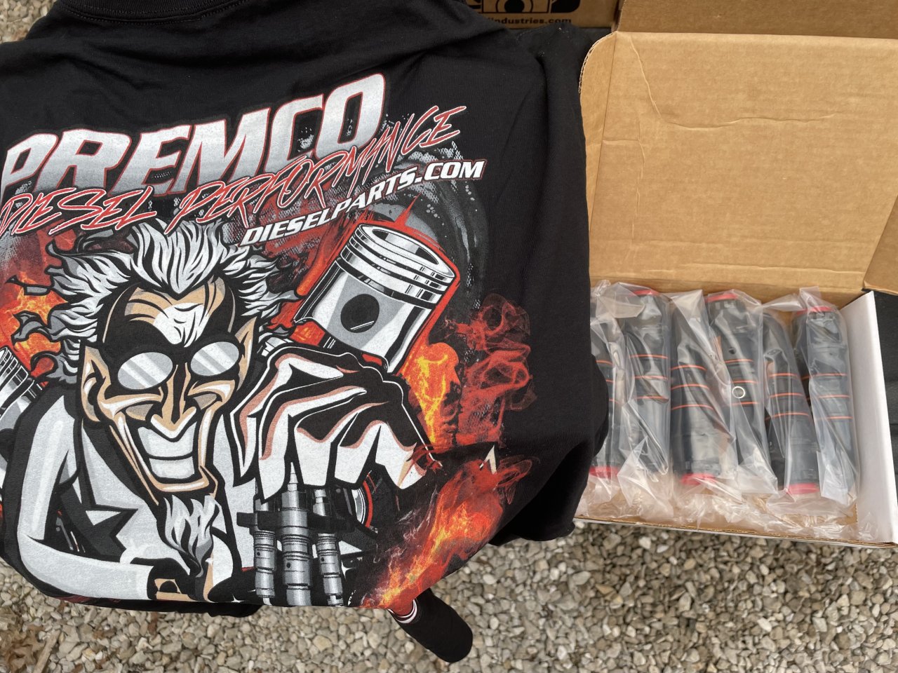

    Sometimes the best thing is the simple thing, a nice set of injectors along with a matched pump may be the ticket for you?
    I just got my new firing pins from Premco yesterday. Little larger than stock and all flowed and matched evenly.
    I’ve used injectors from other shops, but Premco seems to have the edge on the others, at least from my experience.
