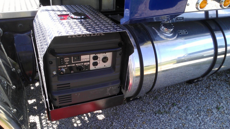

    Obvious which way I went...
    I service the generator either when I am sat for a day or two, or when I get home. Under a qt of oil is really no big deal to replace in my opinion. No filters, just .6qt of oil. Takes @10 minutes to do a "service" on the EU3000. Had 2 of them now, on my last truck as well as my current truck, and they have both been totally flawless. Never heard of too many people with an APU say the unit has been totally fault free.....
    For under $3k, I have colder AC than any of the floor mounted units, heat, battery charging, and AC power. All in a package that is both a LOT lighter and a LOT quieter than any apu on the market. Yeah, I have to refill gas cans every few days, but I'm just not that lazy where it becomes an issue. I also drop the trailer and fill both the generator and cans at the RV islands too.
    Mind, pilot cars also make life easier when I have them, for getting gas.
    Battery powered stuff is fine, so long as you never sit for more than @10hrs. When I spend my money on something though, it needs to cover multiple bases, not just 10hrs of heat/ac, and so on.

    LLtrkg:Nice neat and clean set up! Now tell us how it works: do you have to plug cords into the generator every time or do you have it prewired? Is it remote start? What do you use for heat? Thanks

    Took the foto before the wiring was in place. Just dropped the truck off at Detroit, or would take a foto of the wiring. Basically, the wiring for the rooftop ac and the GFI outlet inside, is run through flexible conduit from under the bunk into the generator housing. I then made a jumper to go from the AC plug to a normal household plug, to be able to use shore power to run the rooftop ac in summertime.
    A battery charger is mounted inside the truck, next to the GFI outlet.
    Wireless remotes are on Ebay, so it has one on it, just like my last one did.
    For heat, I use one of these. Works great on the low setting, has a thermostat, and is easy to store when not using it,
    http://www.ebay.com/itm/Honeywell-H...ced-Surround-Space-Heater-Black-/190810877736

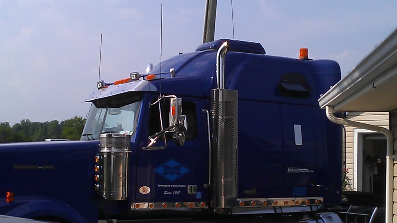

    Rooftop AC is the best, simple as that. I have been in trucks with APU's, and floor mounted AC. Heat rises, cold air falls, anyone can figure out which system would work the best. I cut a hole in the roof of a brand new Western Star, if that is compliment enough for the rooftop ac.
    12hrs of AC takes @2gallons of gas. Tank holds 3.6 gallons, plus I have the gas cans.
    It can run the heater on low, and the block heater, for @8-9hrs on a tank of gas. I never really bother with the block heater though to be honest, it wont stop fuel from gelling up.
    Only time I idle the truck is when the real temperature is below 0f, due to the possibility of fuel gelling. Anything over that, the generator is running saving me money.
