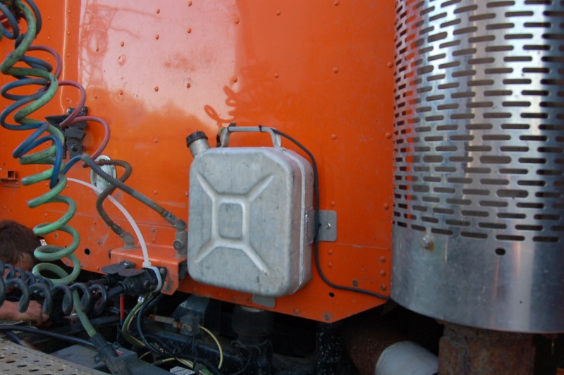

first of all I advice you to install small tank for bunk heater. when diesel is cold it is thick and it is hard to lift it up from fuel tank. I used aluminium can to do it.
the other bad thing I sugest is that you have carbone deposits on evaporator and heater cant start when it fuel is thick so may be it is time to change evaporator and clean heater inside.
If you wanna keep heater tide inside use kerosine, jet fuel in mixture with diesel fuel when it is really cold, especially below zero. that's why I use small tank for heater)dannythetrucker Thanks this. -
