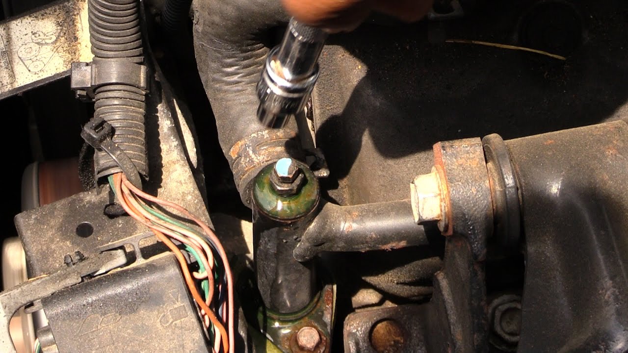

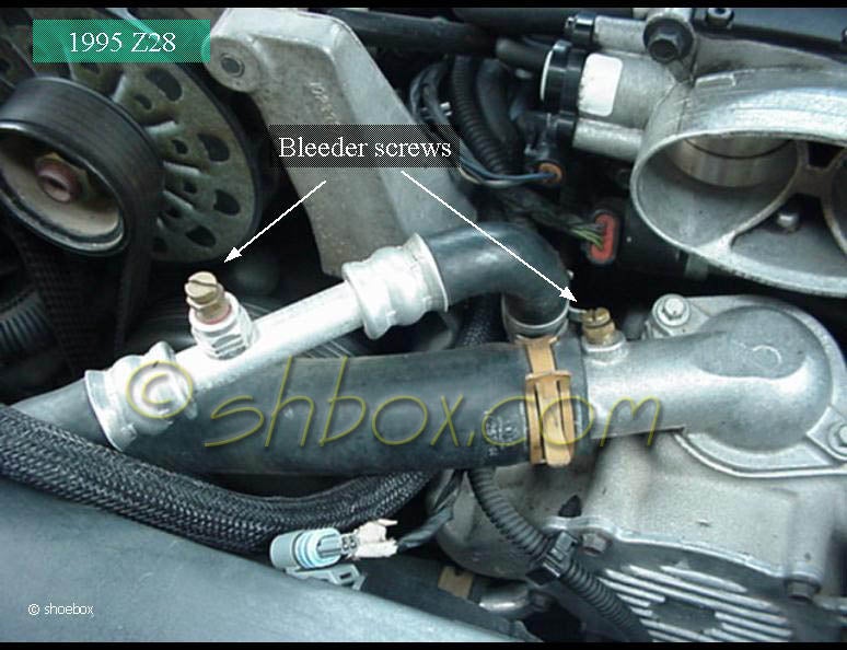

    do as i suggested, drive the steers up on some wooden boards, to raise the front end a few inches. the air trapped inside will stay there, since the truck is on "level" ground. you need to raise the front end to allow the air bubble to get up to the top and get out.
    also, look for bleeder valves on the top of the engine, like at or near the thermostat. follow all the coolant lines for bleeder screws.
    some idea on what and where they may be located.
