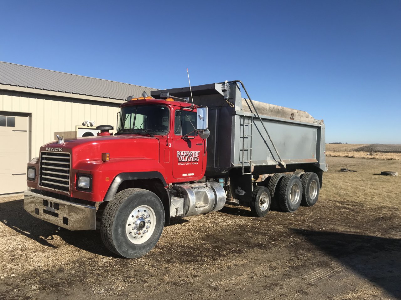

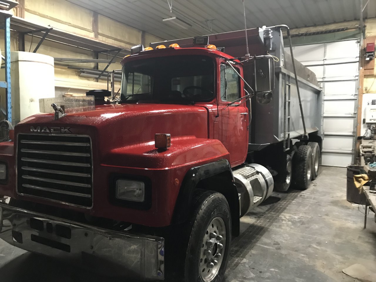

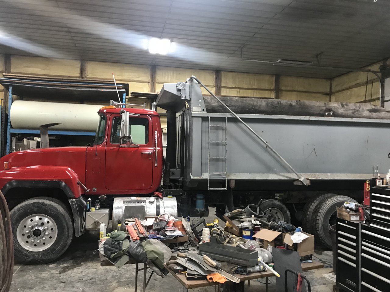

    1575D95F-8A9C-4DD9-8499-A7A11BB1B5E7.jpeg 7014E369-DF76-4DFC-9DCB-796879102BED.jpeg AEF4BEA5-40E0-4FF9-9523-9D5351D262A4.jpeg
    Here are the pics of my truck, picked it up last Friday (1/4)
    1999 Mack RD688S, E7(400hp), Eaton 8LL, 16.5’ box with high rise gate. Getting the logo painted on Thursday! So far very happy with this truck
