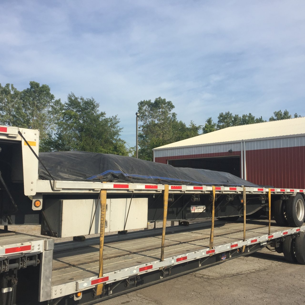

    Most people call the extensions “skirts” from what I hear. I carry a couple of 6x18 sides from a old tarp. It works to cover the bottom of some taller loads and also doubles as padding in a pinch. The only tricky part is you can really bungee to the skirts. I usually nail them up. You can kind of see then under this load. FA399602-48B6-4ED4-8115-9AB0D7638845.jpeg

    I know this is a dumb question to many of you, but how do they get a trailer on top of a trailer like that? And outside of the straps I can see in the picture, is there other securements? Like when you transport like that, do you have to have 4 points of contact with chains also? And what would be the reasons you transport like this?

    Stacked them with a large forklift. I do usually use 4 corner chains on stacked trailers. If I’m only hauling a stacked trailer I will just use 4 chains. This load I just counted the straps over the fright. Both options are legal in my opinion.
    as for why, we’ll I sometimes ask myself that same question. Usually to reposition equipment to different yards that have that type of freight. We try to grab a partial to at least cover our costs on those moves.
