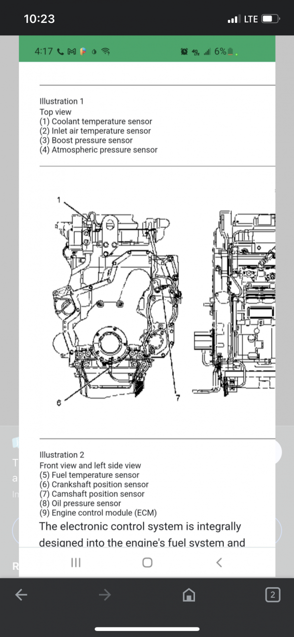

    Hello, I have a no start issue with 1998 C12 in 98KW 900. Can only locate one sensor on (R. Side) of front structure timing cover. Most posts ive seen are calling for one underneath near front of oil pan and one on (L)side of front structure (Looking for engine speed sensor) If im correct that there is only one eng. sp. sensor does anyone know what ohm reading I am supposed to get between what wires? Sorry eng. serial # not available at the moment. Any help would be great, Thanks.

    Being a 98 I'm going to guess that it has the 40pin ECM, if this is the case it will only have the one speed sensor, the second one wasn't added till they switched to the 70 pin ECM's and that speed sensor would be down low on the left of the front structure reading off the crank gear.
