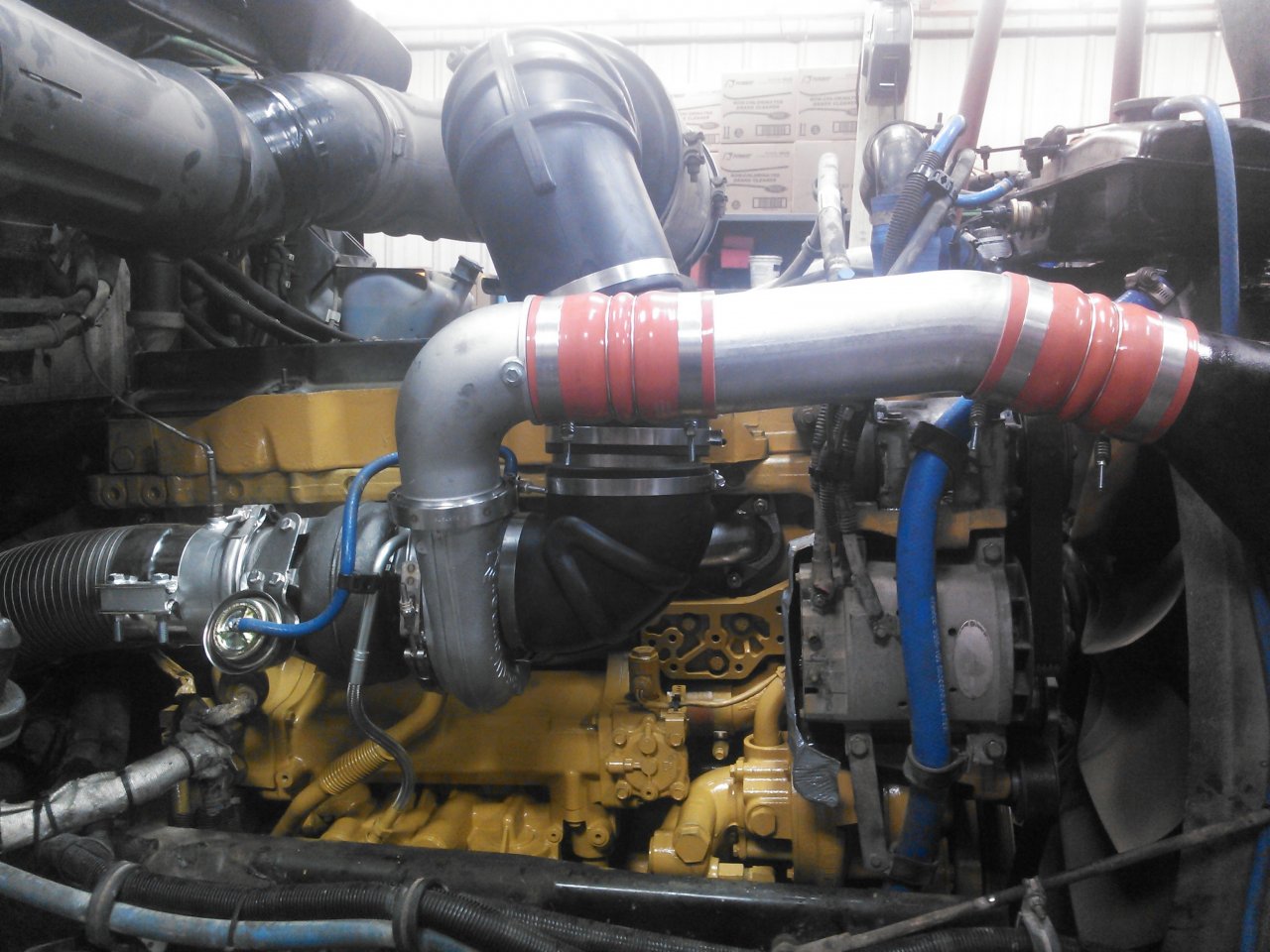

    Look nicer with a single!

    I had an 05 C13 in a Paystar dump truck. Thought I was going to be disappointed (would have had to wait months for a C15 build at the time) So it was pre DPF. It was awesome. Truck had a legal gross of just over 79,000 pounds. I averaged 5.3 MPG. Never had a mechanical issue with it.
    And it pulled. My friend also had a Paystar, we both scaled out the same with asphalt, both had 18 speeds, 4.30 rear ratio's and 22.5 rubber. He had an ISX565 and on an 8% hill he passed me but couldn't pull away, I could stay stuck to his tailgate. Mine was set at 470/485, 1650 torque. I later had them put in the 525 field uprate.
    Why not just get another C13 or rebuild that one? The C12 is a good motor too, so I guess whatever is cheaper for you. I've seen stock C12's with just the waste gate line plugged that can out pull a Series 60 500. Picture 057.jpg Picture 057.jpg
