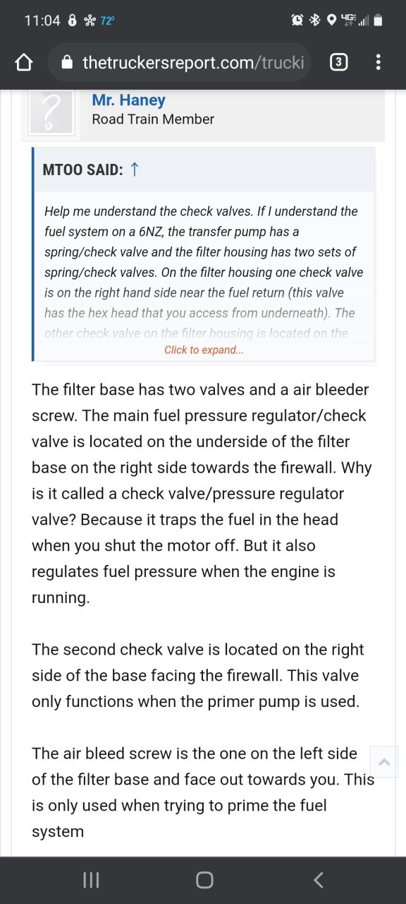

  10. lester
    lester Midwest's #1 Feed Hauler
    2,918
    7,876
    Jan 2, 2012
    NW, Iowa

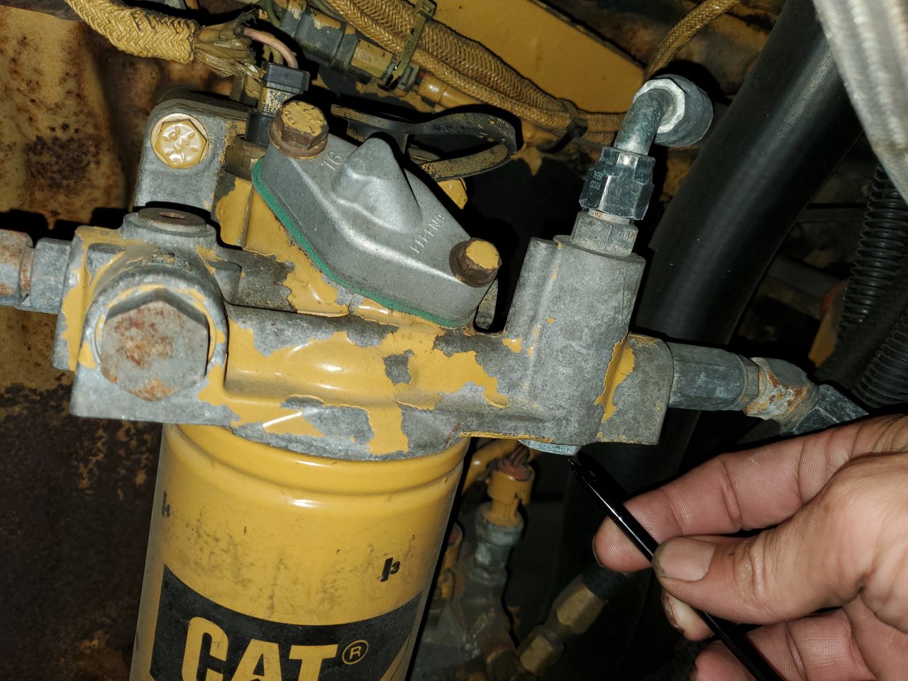

  11. skallagrime
    skallagrime Road Train Member
    3,850
    9,919
    Apr 10, 2012
    Indiana
    Return check valve, what my stylus is pointing at do it again
