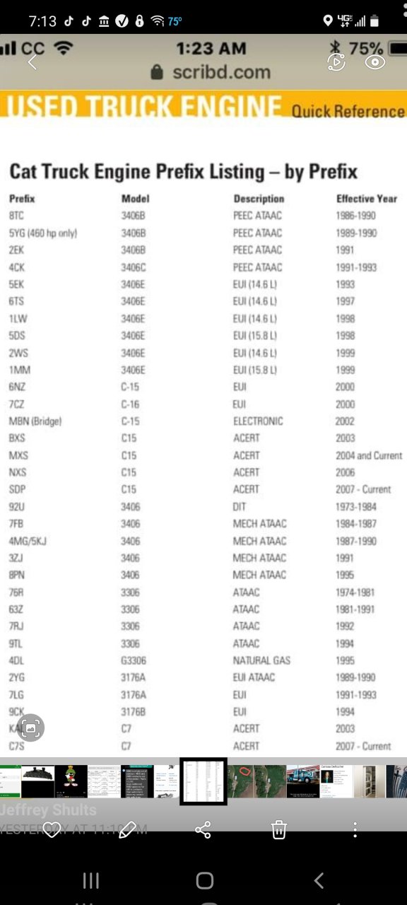

    The 3406E is 14.6 liters. Everything after it from the C15 and on are all larger.

    No there are E models that are 15.8. 5ds. 1mm Screenshot_20210904-191358_Gallery.jpg

  4. ProfessionalNoticer

    Apr 25, 2021
    I did not know that. I have a 5EK.

    I have a 5DS in a 98 flat top that says 3406E on one valve cover and 15.8L on another. It also came as 600hp. 2050 on torque 18 speed 3.36 rears etc. everything about that ####### is heavy. Ain’t nothing it won’t tote either.
    Not all C15 are 15.2L they were 14.6L till the Acert.
