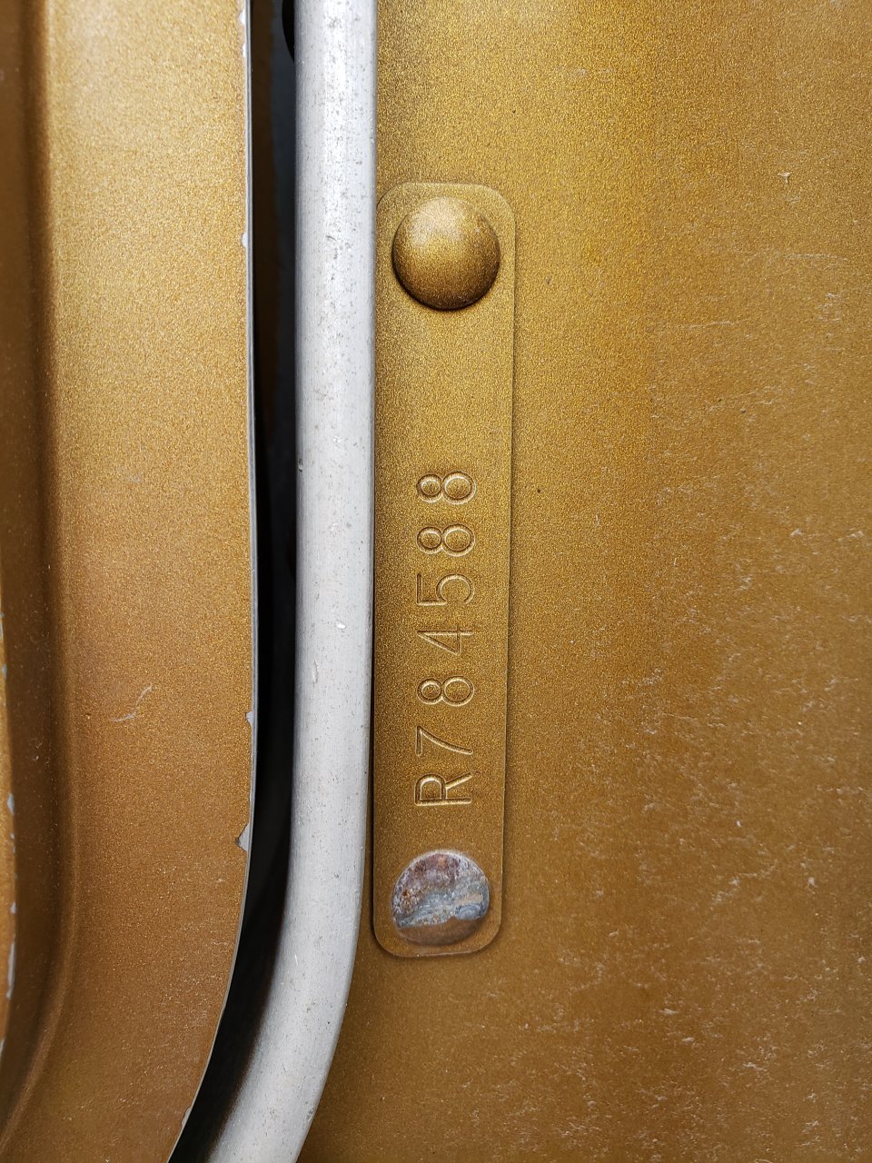

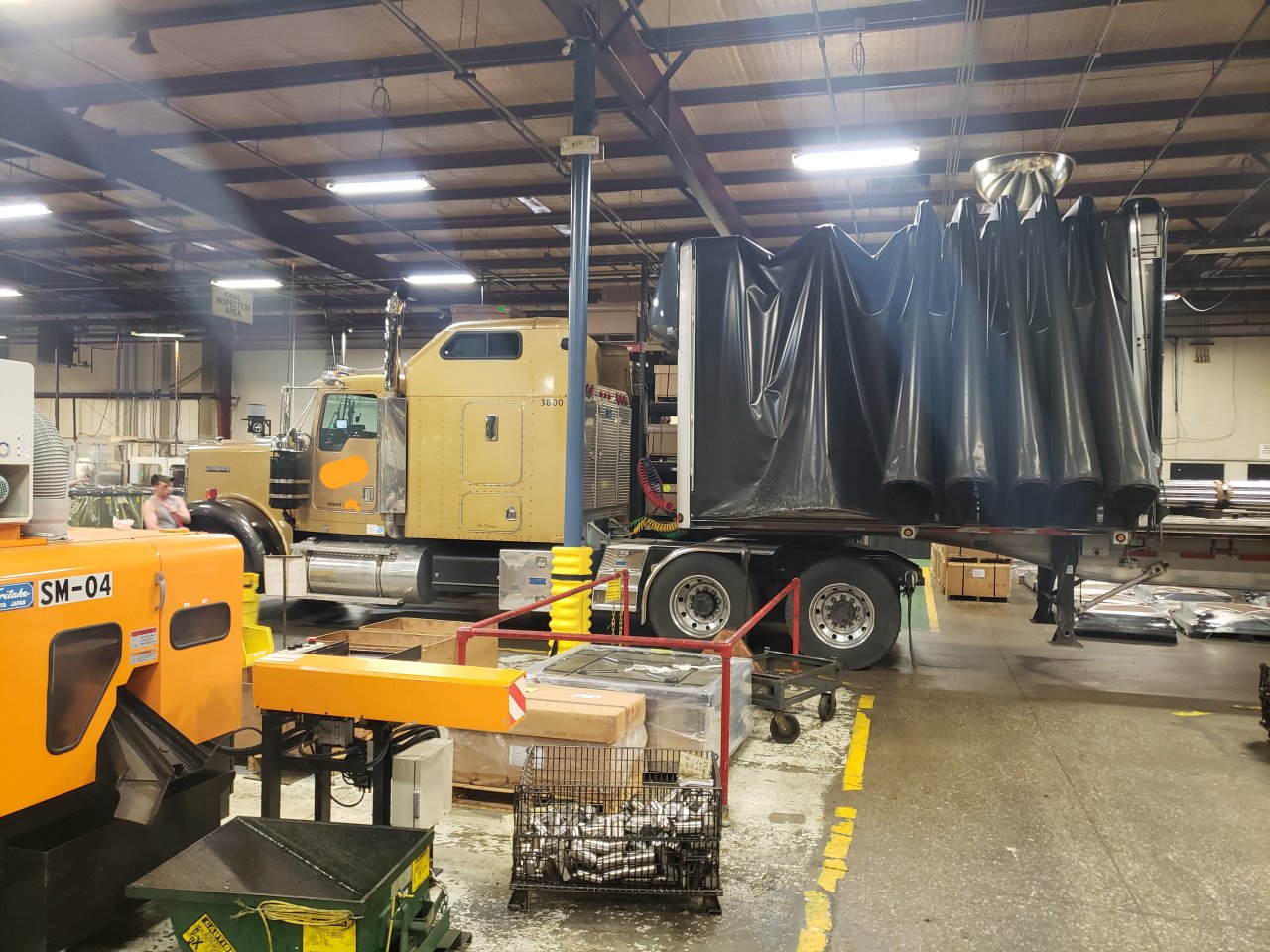

    I have a vin if you want to try and get kenworth factory setup. Its a 98 w900. The cab and sleeper have separate systems.
    Ruthless Thanks this.

    Thanks for the info, I am going to start on my project next month. I will check into the factory setup.
    Sharp looking truck.
    Have you done much to the inside of the cab? Interested in any updates you might have done.
