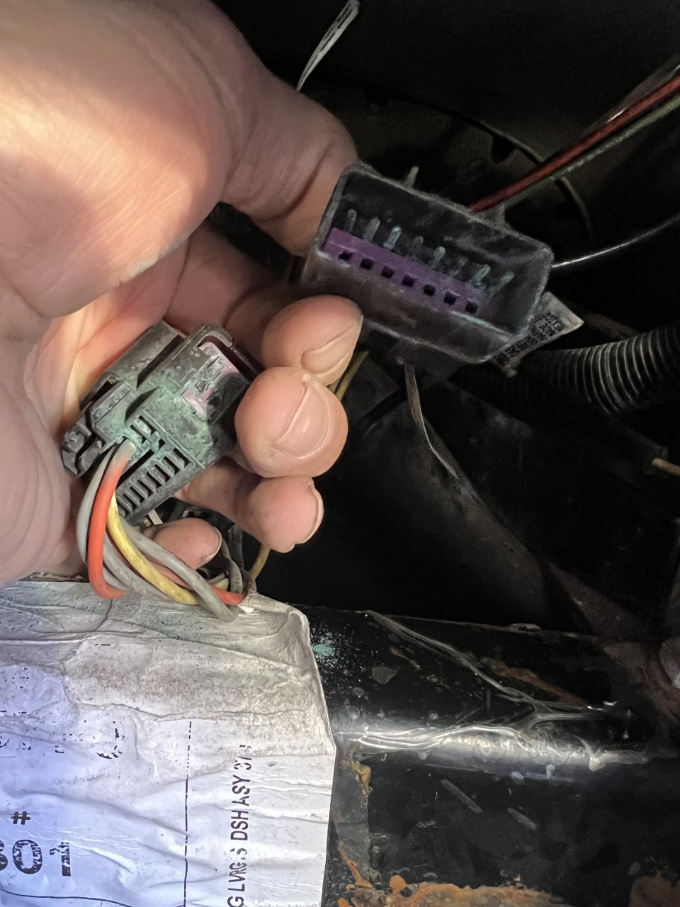

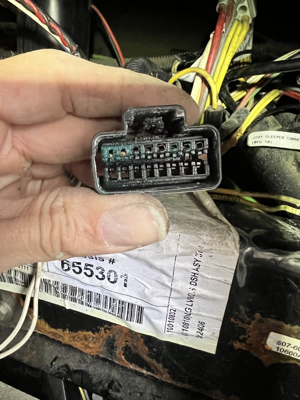

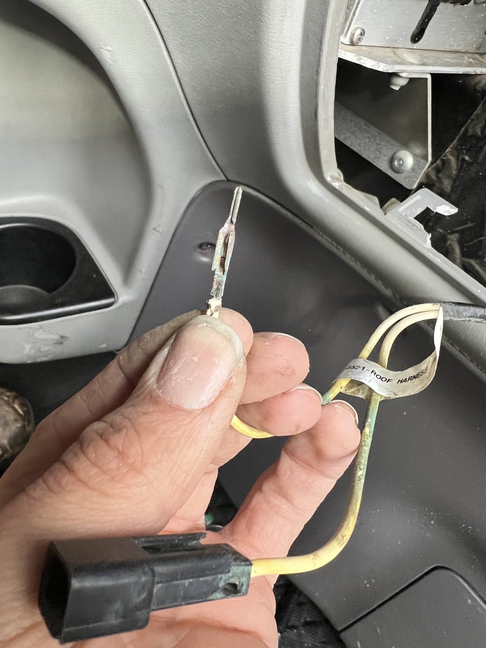

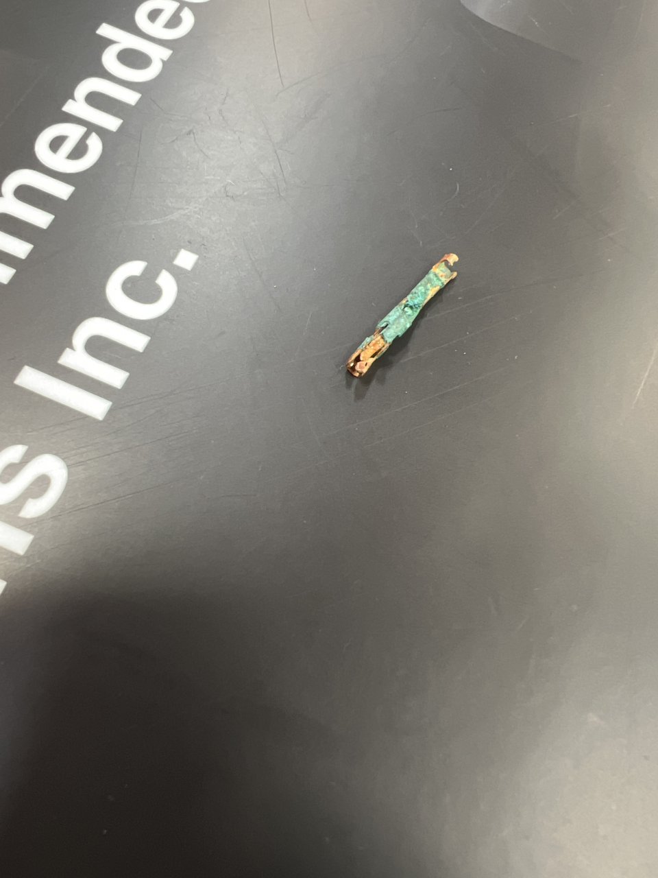

    You are correct, except it’s corroded down at the connection to harness behind glove box. Gonna take those connectors apart today and match terminals at Napa. Hopefully I can get it all repaired today, shouldn’t be too bad as long as I can get the hang of pulling corroded terminals out of their connectors.

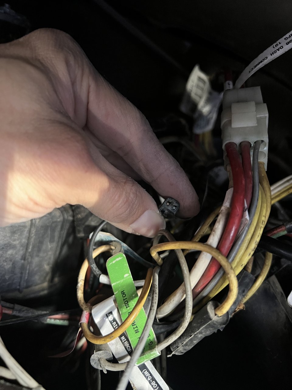

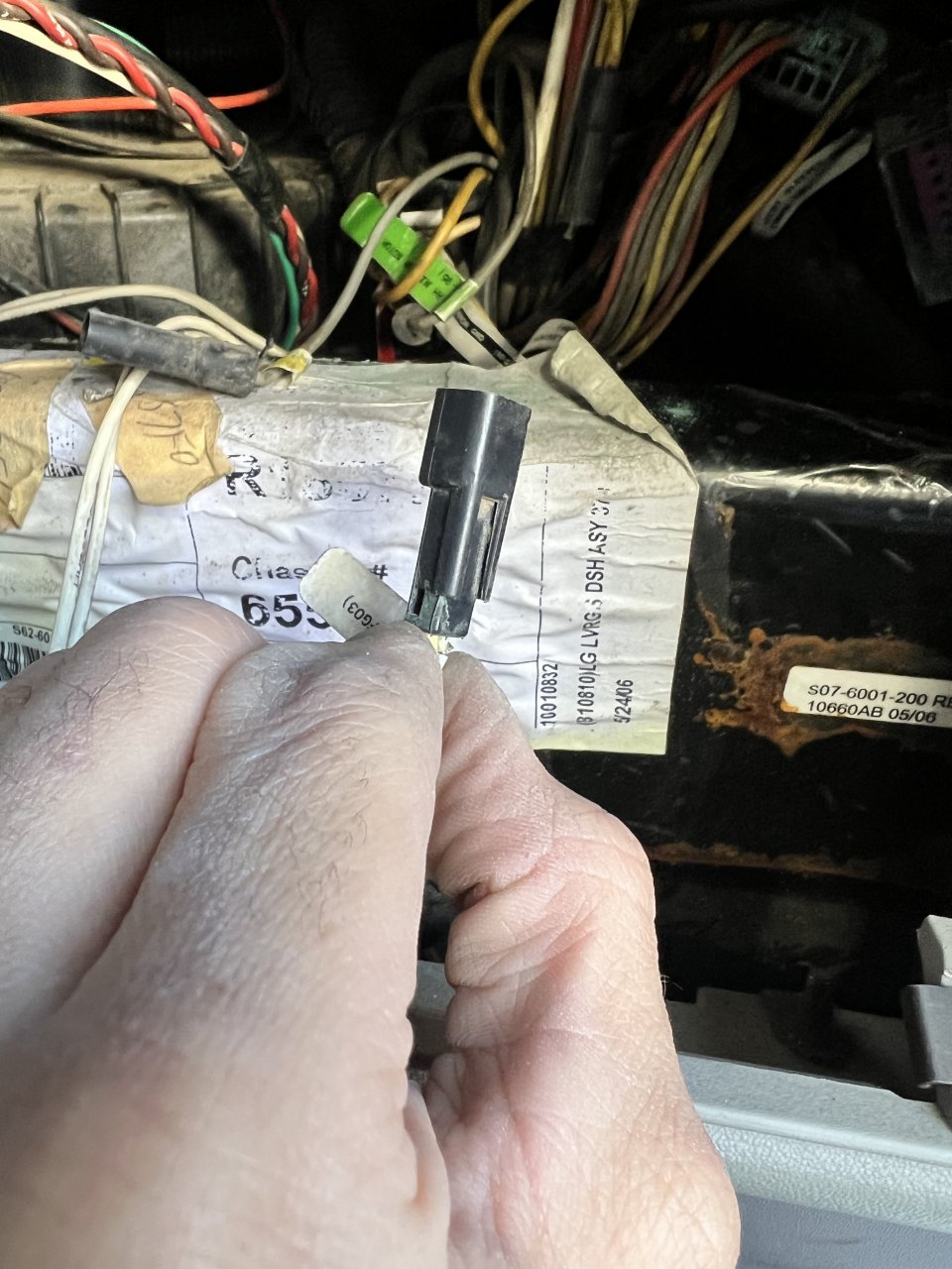

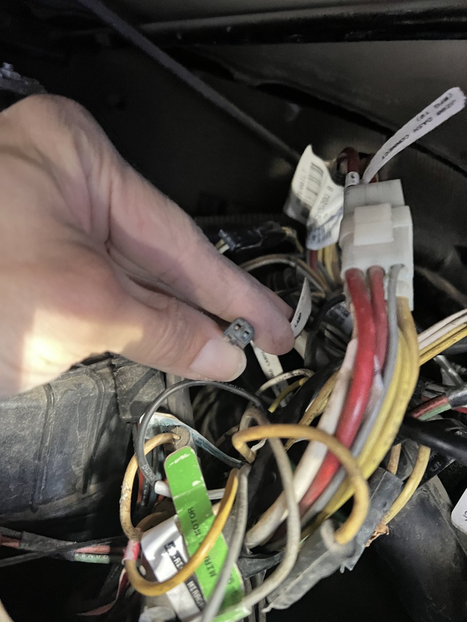

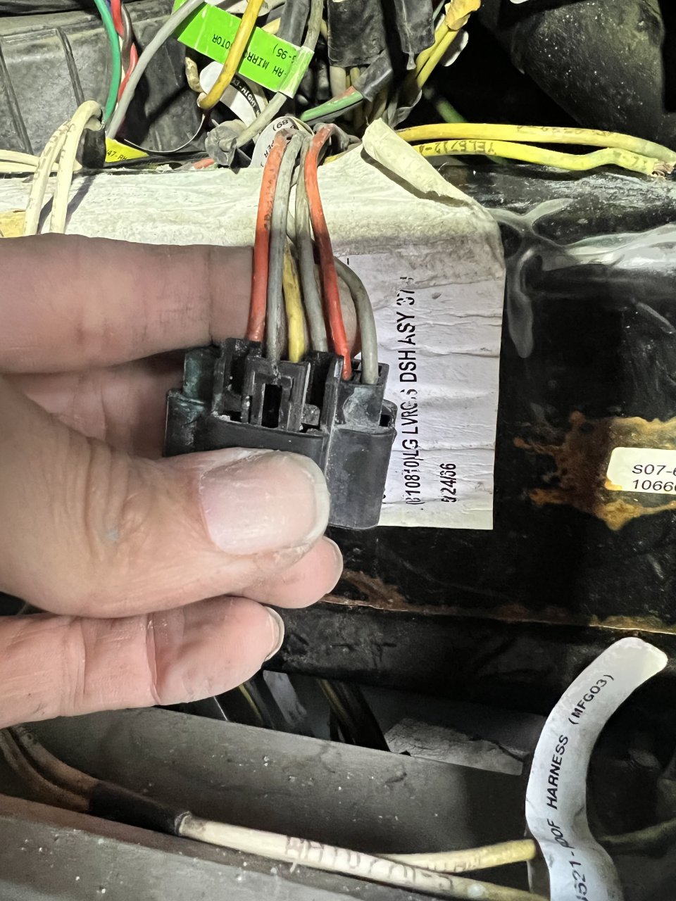

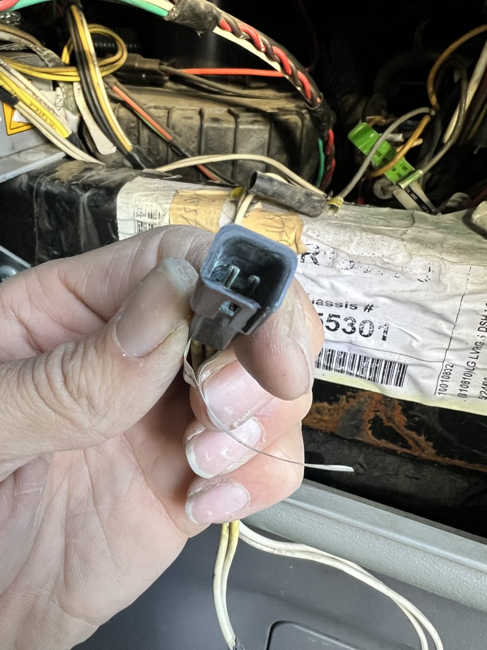

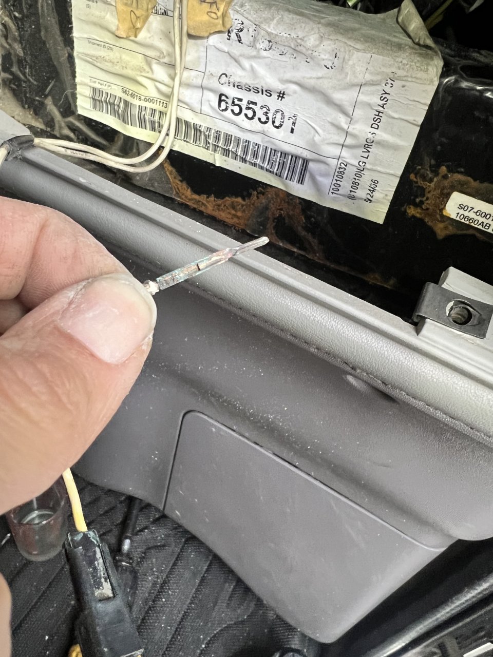

    here’s what I found. The females behind the harness plug I’ve gotten the corroded terminals out, but Napa is currently having a hell of a time finding them.
  7. RocketScott
    RocketScott Medium Load Member
    579
    949
    Apr 10, 2013
    Kentucky
    It's a little hard to tell the size based on pictures. The width of the pin correlates to the connector size: 1.5mm = 150, 2.8mm = 280, etc
    The small 2 pin connector looks like a metripack 150
    Page 58 (page 4 pf the PDF):
    https://docs.rs-online.com/f13f/0900766b814c67ea.pdf
    The larger 16 pin connector looks like metripack GT series, also 150
    Page 13 (page 4 of the PDF):
    https://www.powerandsignal.com/docs/catalog/gt150.pdf
    Measure the width of the pin to make sure. Terminals come in a couple sizes to accomodate various wire sizes, usually the larger size is what you need. Mouser, digikey, or other places have them, just search for the terminal part number. I don't have any of the GT series terminals and only a few of the regular metripacks otherwise I'd send you some
